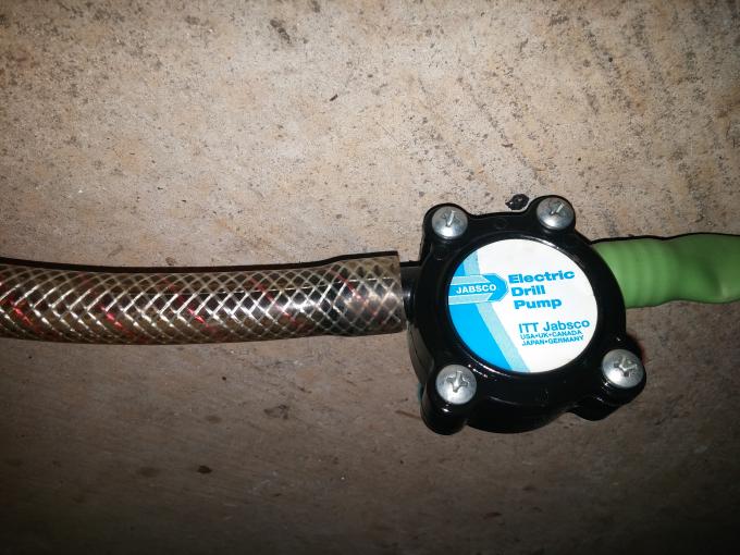

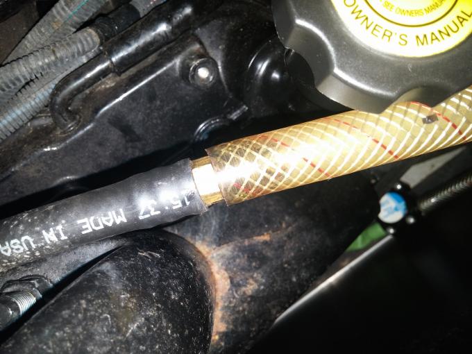

    I have a clear hose with white thread reinforcing the fits perfectly over the threads, tight enough that I can suck it out with a drill pump. Put tape around it the first couple times to prevent a loss in suction....tried without the tape and it works just as good so I no longer use the tape

      Dino,
      Can you send some pictures of your clear hose and white threaded section?

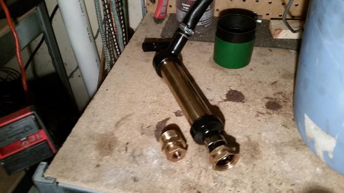

        I bought a FNPT to hose barb swivel adapter and a stainless steel hose clamp. I can't remember the exact thread size for the drain fitting and the hose barb size will depend on your drain pump hose size. This will allow you to thread right on to the end of the drain hose

          Sounds like mine is similar to above. See pic. Just go to end of drain hose. Oil change is about 20 minutes.

            Here ya go
