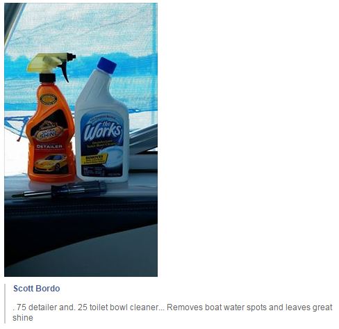

ID:	449981 If regular hull cleaner does not work just use toilet bowl cleaner, yeah really. Combine these 75% / 25% it will be so awesome you will never buy anything else for the gel again. Just dump out 25% from the detailer container and pour in toilet bowl cleaner. Shake often. It doesn't even explode. But shake often as it does not really mix that well. If you need it even stronger then just make it more toilet bowl cleaner.
