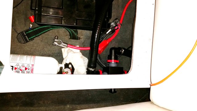

                              • faralta
                                • Aug 2013
                                • 18
                                • Clarklake, MI
                                • 2006 sante 210
                                #30
                                Finally got some pics of the soft bag (on top of hard tank) and the manifold I installed:
