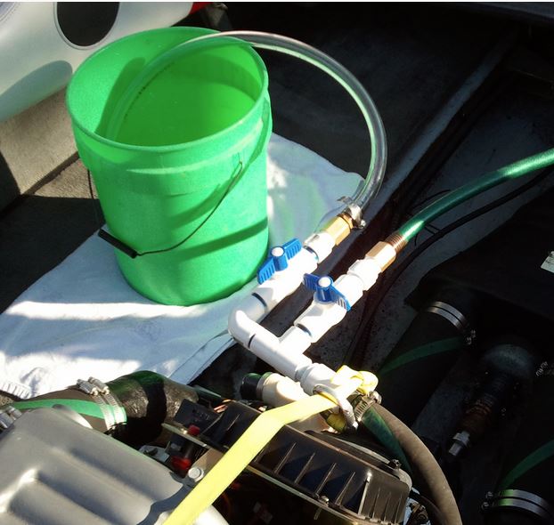

        I pull the water intake hose from the strainer and connect a garden hose to provide a water source in the garage; I use a hookup similar to this link from brennank (http://www.planetnautique.com/vb3/sh...ht=winterize); run the engine until it reaches operating temp (ensure that you have water flowing out the exhaust during this operation); then I switch the water off and turn the valve so that it pulls from the bucket of antifreeze until I see plenty of antifreeze flowing from the exhaust (usually about 5 gal). Turn engine off and change oil using the a fluid extractor connecting the extractor to the oil drain hose. Oil drains very quickly. I have used Shell Rotella 15W-40 for the past 10 years with my 343 engines. Many members on this forum will tell you to drain the block but I just leave it full of antifreeze as many dealers do. Although I live in Ohio also, my boat is stored at the lake on KY/TN border. You are welcome to PM me with other questions or you can contact me via my cell 937-239-1219.

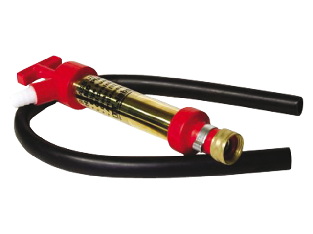

            I prefer to use something like attached. I just got a couple fittings so I hook up this to end of drain hose, pump out into a gallon container. Get's it all from the bottom of drain pan, and takes only a few minutes. That way I don't have to deal with getting the hose thru a hole in bottom of boat.
              That's how I do mine. I use a Tempo with a fitting attached to the drain hose.
