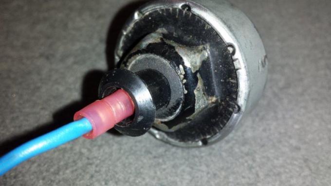

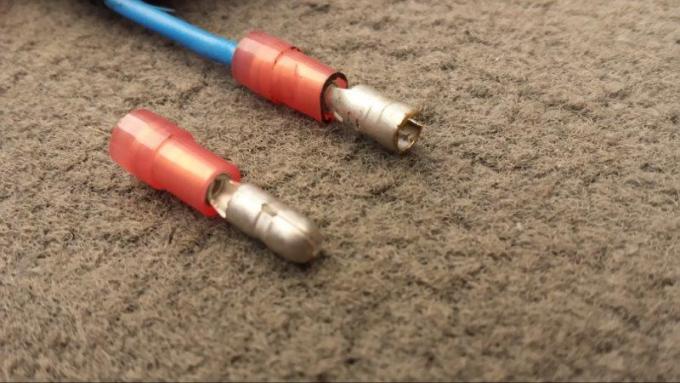

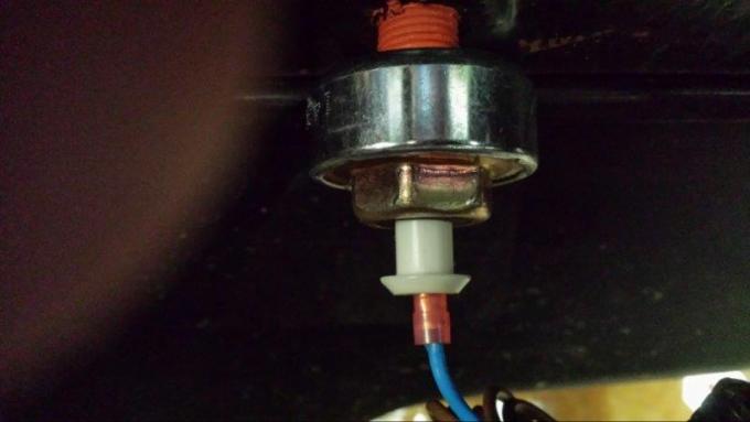

      Thanks Daryl for the tip.
      I had already looked at the connector as a source of the problem and decided to modify the connector as I thought the original was lacking.
      So I found a male bullet electrical connector that if you grind the end off makes a much better electrical connection.It connects over the outside of the sensor pin.
      I have also tested the continuity from the sensor connector to the ECM plug J1 in 17 and checked the resistance which showed as zero/ohms
      See the attached photo's .
      Knock 3 shows the original vs. modified connector
      Knock 2 shows installed into a sensor.
      Knock 1 shows installed on a brand new Nautique. parts supplied sensor on the engine.
      Please keep the suggestions coming to fix this problem.

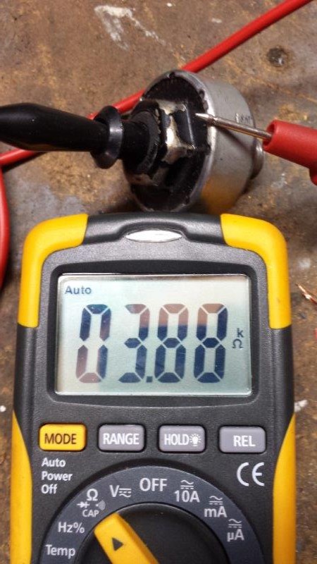

        More Checking - The below is and extract from the MEFI 4 Diagnostics manual ( page 259 of 337 ) for trouble shooting a Knock sensor DTC 44
        I'm trying to figure if I have the correct resistance for what is specified in the test.
        Leaving the wire connected to the sensor and removing the JP1 connector from the ECU from pin 17 I measure 3.85 k ohms resistance to ground.
        This is nearly exactly the same as just measuring the Knock sensor alone on the bench.( see attached photo )
        Does this indicate a fault that the wire is a problem and should have more resistance ???? ie 93 - 107K resistance as per the procedure ?
Name:	Knock Resistance.jpg
