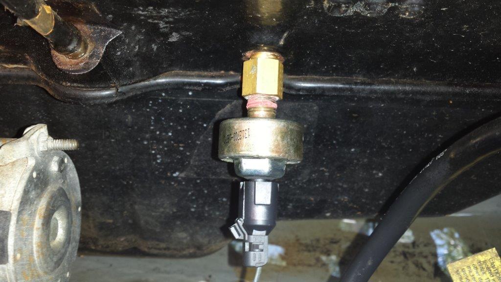

        Hi. Still have the Knock sensor issue re-occurring.
        Re-set the error code on the Diacom and went out to test two different set ups.
        First was with an extension fitting on the knock sensor. ( see picture )
        Second was a right angled fitting bolted to the front of the engine next to the harmonic balancer.( see picture )
        Both times the error code appeared only after accelerating to around 3000rpm.
        No error is present at slower speeds.
        Also checked hat the engine has had the up-dated / recalled coil to distributor cap wire replaced.
        This does indicate that the is detonation at higher speeds but I'm at a loss to solve the problem.
        Any advice would be appreciated.
        • Paxdad
          • Mar 2013
          • 775
          • Cumming, GA
          • 2008 210 SANTE
          I believe that your problem is associated with the fittings located on the sensor. The sensor should be mounted directly in the engine block. Just thinking out loud is that the fitting is interfering with the frequency at which the sensor detects a knock in the motor. The sensor acts like a microphone of sorts and is set to signal the ECM in the event of extreme detonation knock.

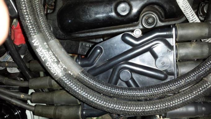

                          Hi all.
                          Was checking the timing " Cam Retard" settings on this engine ( 5.7 Excalibur ) and was going to run the boat at a setting a couple of degrees below spec to see if would remove this " Knock Sensor " problem I cannot seem to get rid off.
                          The attached photo shows the distributor cap mounting screw touching the inlet manifold when the timing is set to 40 Degrees.That is only 2 Degrees below spec.
                          Could I ask someone check there engines and post a photo of the distributor and see how much clearance it may have to the intake manifold if it was set to 40Degrees.
                          Thanks in advance.

                          • jhersey29
                            • Nov 2013
                            • 330
                            • Colorado
                            • 1971 Correct Craft Mustang 1988 Ski Nautique 1992 Ski Nautique 1999 Ski Nautique
                            The manual shows 43-47. Are you getting the rpms above 1000 when checking?

                            • Muzzab
                              • Apr 2012
                              • 15
                              • Victoria,Australia
                              • 94 - Correct Craft " Ski Nautique" 2004 "206" Ai
                              Hi. Yes I have been running the Cam Retard setting at 43 Degrees and this was set with the RPM above 1000. Viewing the graph on the Diacom software you can see that it only moves around 1-2 Degrees from that setting when running the engine.
