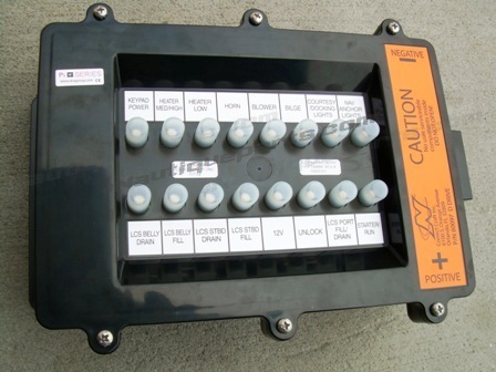

              I have Breaker Panel part #S6289 under my dash but I really don't know how it works as it looks like it has little rubber caps over each circuit... it could be a darn breaker but I can't see how they operate.
                They will be soft if the breaker is okay but firm if it has been tripped is my understanding. Basically a little push button for reset.

                      Would the "start run" breaker on the panel be a reason for it to not stay running after starting successfully? Based on its name I would think you could not start at all if it was tripped.

                            So education is a good thing and I have learned a lot about my boat.... All it was was the breaker in the breaker panel in the kick plate. I put the ignition boot on and cleaned up the wiring a bit near the relays. Went for 2 boat rides
