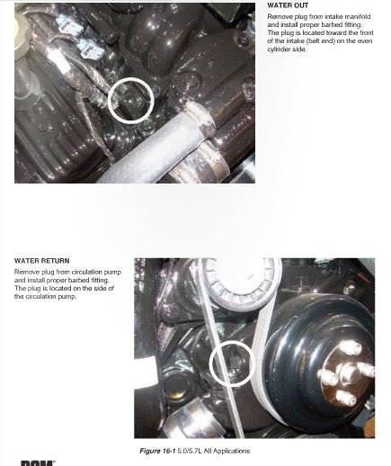

My heater does not appear to work. All summer my family complained about the heater blowing cold air. My neighbors MB Sport blows very warm air. Last year when I winterized the boat, I blew the heater out with air, then completely filled it with RV antifreeze just in case. This year when I went to blow it out I actually blew some of last years pink fizzy RV antifreeze out of it! Kind of sucks that a factory installed option like this doesn't even work? Do you have to install the circulation pump inline to get these things to heat? Is there a way to get the water pump to actually pump water through the heat exchanger, or is the fact that we are pumping from the intake manifold through the heater to the water pump, and not to a radiator like in a vehicle the reason it doesn't work? It must be roughly the same pressure, and the lines just stay static? If anyone has a heater that works, could they take pictures of where the hoses connect to the engine and water pump.
