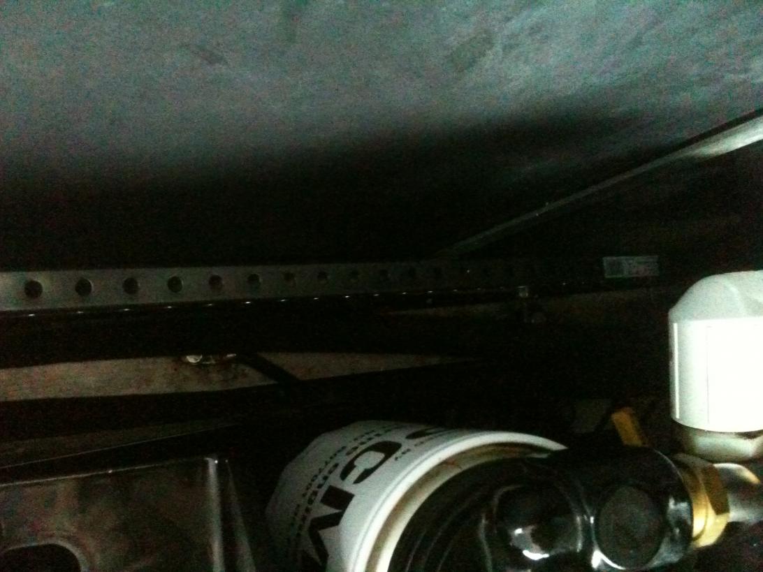

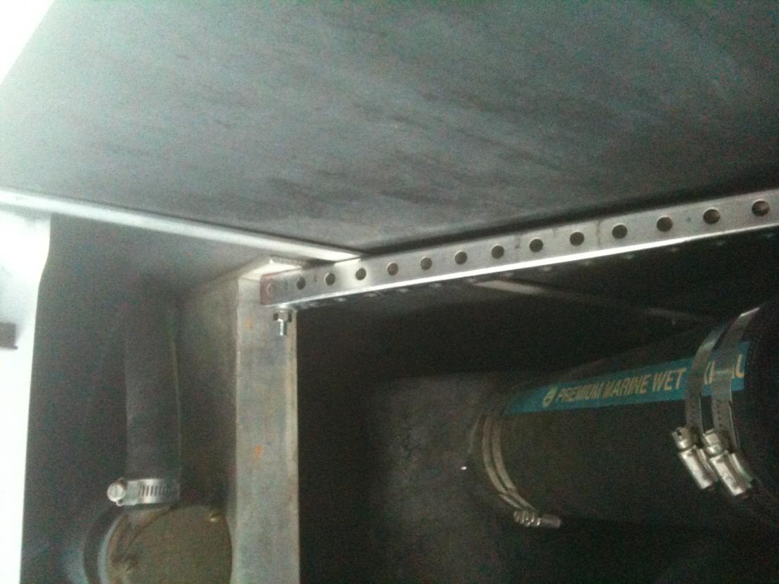

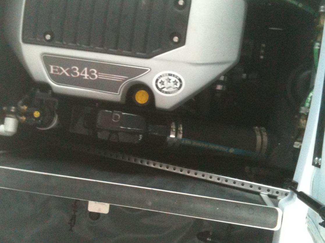

      This thread needs pictures...

        2008 sante 210 It has never been in the way. Does NOT attached to the divider itself, so just pull the oem pin and pull divider ight out.
