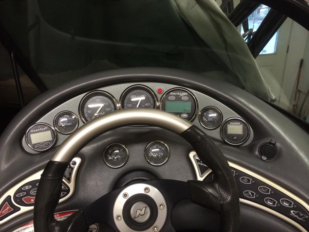

Boat is a 2003 Super air nautique. When I bought the boat it was missing a gauge on the right side of the display. Haven't been able to figure out what gauge is supposed to be in there. Any help would be greatly appreciated. I believe the boat is a limited edition. Thanks!

Guessing the 4 you have are. Oil pressure, engine temp, fuel tank level, volts. two other good ones are depth or air and water temp. One gauge might be able to do all 3 but not sure.

Yes, the four I have are what is mentioned above. There is no transducer under the transmission. I plan on adding a depth finder. I was mostly curious what was in there when it came from the factory. Thanks for the responses!
http://www.nautiqueparts.com/dashpanels.aspx is was factory with 4. Says to cut an extra hole for cruise control. Looks like they also cut ab extra hole for perfect pass. Best guess based on OEM parts.

That looks really good. Did you install a depth gauge? Looks like you did. Did you drill through the hull or use a transducer?
Faria makes a nice depth finder with air/water temp, and there are several choices for transducers. I used a glue down through hull that sits in mineral oil. Its been much more reliable than the glue down puck that adheres directly to the hull.2005 Ski Nautique 206 SE, Acme 422, PP SG 8.0, ND Tower

No I didn't drill a hole through the hull. Its aNorcross Hawkeye D10D Depth Sounder and I got it from Amazon,,,go take a look there and read the reviews lots of great info on installations and also the instructions that come with are good. Always here to help ya out.
