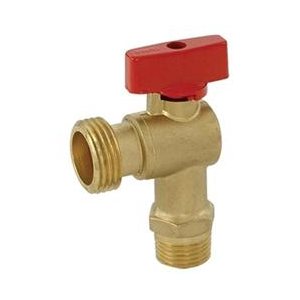

    In the winter we like to make a few runs. So in our 450, I put boiler and p-**** drains in the manifold and transmission during the first winterization. I had to cut the hose bib off the boiler drains so they would screw into the manifold. I have to open 5 drains, take off a hose, the bolt from the cooler and the strainer, and it is done. In the summer I put the plugs back in.

      Yeah I switched the manifold, vid rive, oil cooler, and inter cooler over to valves. The heat exchanger did not have enough clearance so I drilled the head and pressed in a stainless pin.
      Now I can open all the valves, screw out the plug in the heat exchanger by hand, and pull the strainer bowl. I'm still working up something for the hoses so I can drain all water with no tools.

            I did the same but used barbed adapters connected to hoses that run to area of the drain plug and used std valved hose ends to allow drainage.
            I glued in a drain/hose on the bottom of the inline water filter as well. It makes it easier to add anti-freeze to the the system as well as drain the water intake pathway.
            I leave the adapters/hoses connected all year.

                I used two of these for the intercooler. http://www.mcmaster.com/#4847K15 I had to cut the female side down to allow enough clearance to actually install them. And the port side I had to also cut the handle in half.
                These for the manifolds. http://www.mcmaster.com/#4112T63 You will also need these. http://www.mcmaster.com/#4429K412 The t handles on the valves will have to be removed to allow enough clearance to install. Then put them back on when you have them installed.
                Two of these are needed for the 2nd oil/trans cooler. http://www.mcmaster.com/#4112T53 I'm still working on how to get the second one in near the V drive.
                I'll be using these for the freshwater lines. http://www.jegs.com/i/JEGS-Performan...ductId=1206363 But I will be replacing the petcock with a valve. I'm assuming the same valve on the manifolds will work but I will know for sure once they get here.
                For the V drive I used a pipe nipple and brass valve from Lowes. I can't remember what size it was, 1/2" I think. But you can just carry the plug in and match it up.
