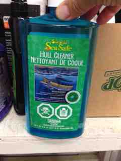

            Dealer recommended this

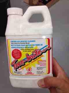

              Tried this

                Both work amazingly well

                  Keep it off of stainless and aluminum parts of your trailer! Rinse lots!

                    Slimy grimy and toon-brite are both amazing! The ski Nautique I used toon-brite (no before photo) the other boat I used slimy grimy.

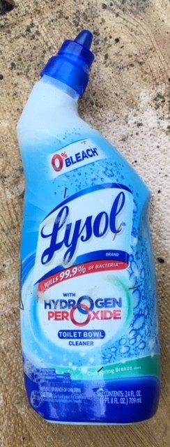

                        YES! i was going to post about this today. the stuff is miraculous! scrubbing is NOT necessary! start with a dry boat then apply the blue gel; i used a paintbrush to avoid it dripping off the fiberglass (a little goes a long way). let it sit for a minute or so, wipe off with a damp rag, then try to believe your eyes! Click image for larger version

                          How rough are all these solutions on your trailer?

                            Extremely caustic to any painted surface, flush well.
