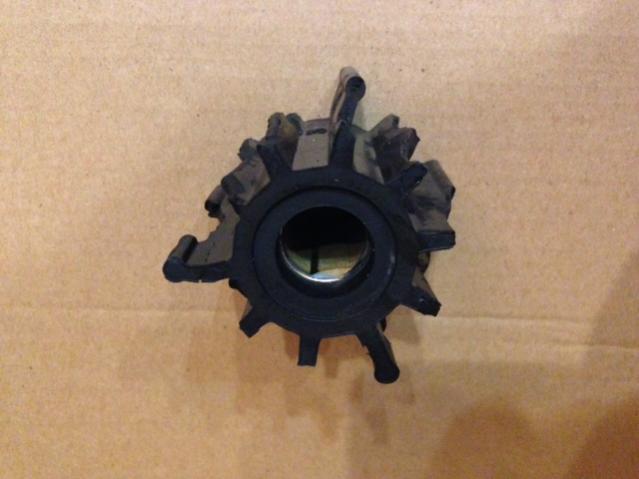

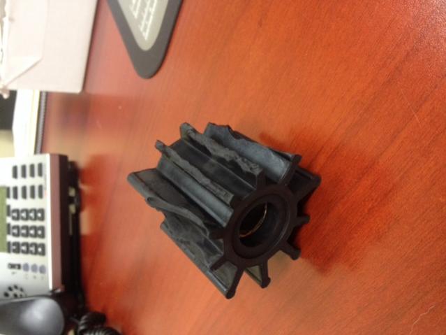

2013 G23 with 240 hours. Replaced raw water impeller at 200 hours as routine maintenance and impeller was in good shape. Boat started to over heat mildly today and tested the vacuum on the raw water input and it was low. Surely it could not be the impeller as I replaced 2 months ago. Yet sadly it was.
Want to make sure I did not do anything during installation that could cause premature impeller failure. I have never had issues before and the impeller change is quite simple. But is there an installation error that can lead to premature failure? Thanks.
Yes the idea of a bad batch of impellers did enter my mind. I am going to pull mine that replace the 7 hour failed unit in another couple of hours use to see how it looks. Needless to say I am a little fixated on my temp gauge these days based on my experience so far this year.
