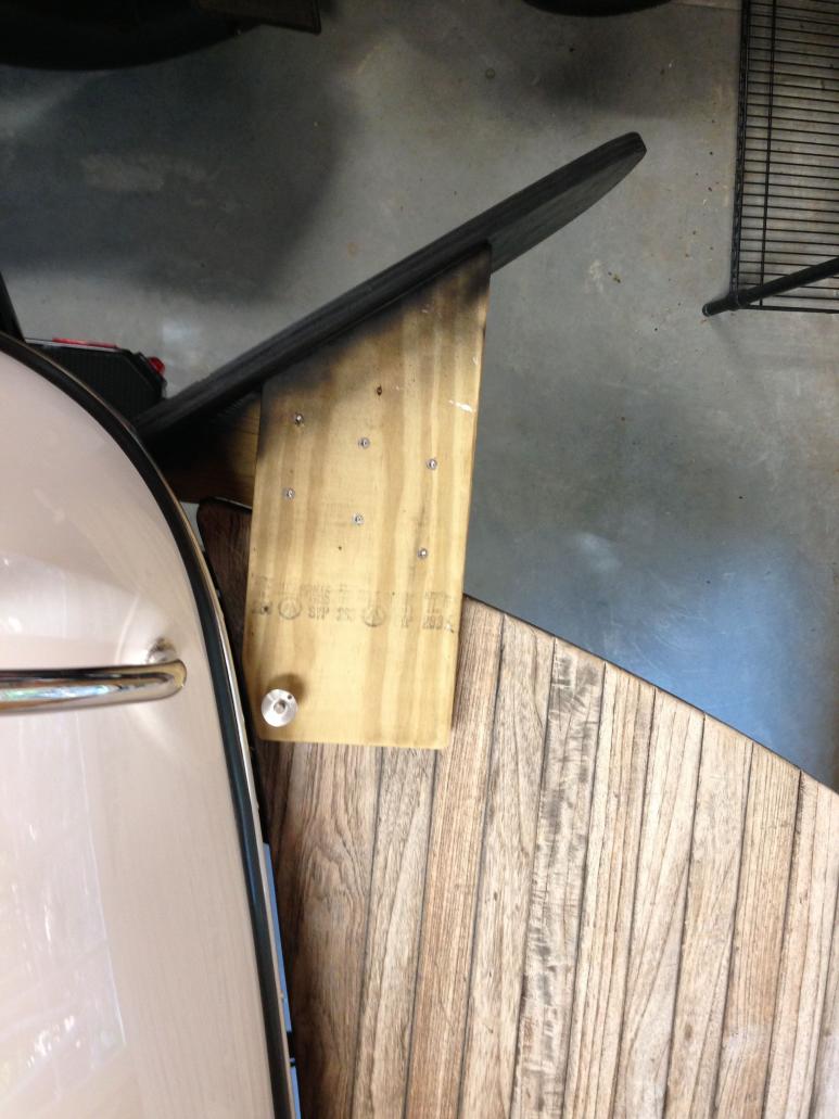

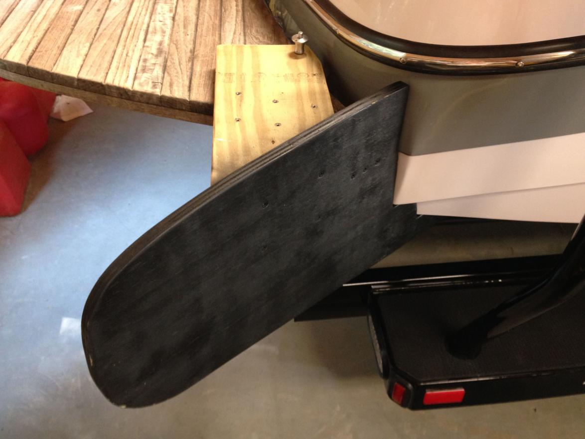

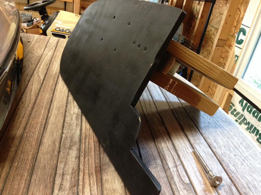

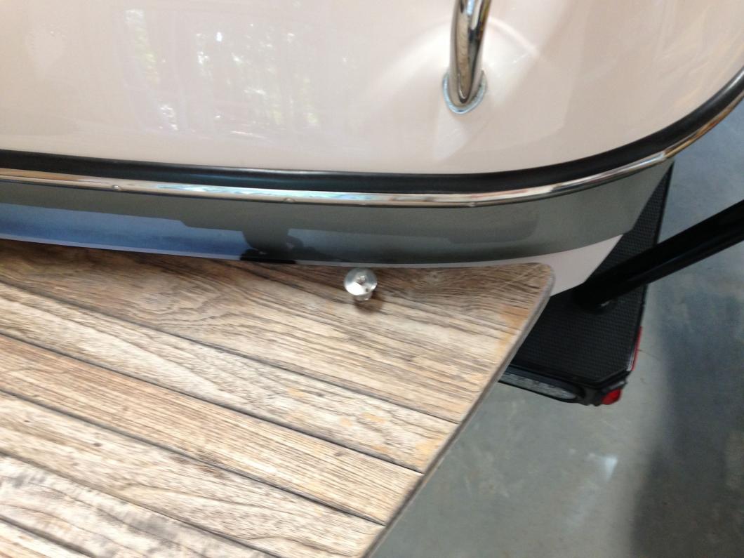

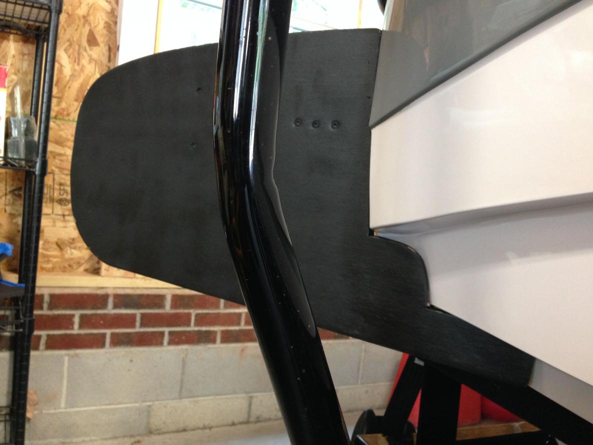

    A few people have asked how this project is coming along. I've attached some picts to show the general design and construction of this v1.0 gate. My plan is to rebuild this with HDPE plastic once I confirm that is works as intended, which I think it does. I don't have a lot to compare it against, but it certainly alters the wave in a big way—maybe too much since the sweet spot of the wave isn't very long. The material is basic lumber and I sprayed the plywood with liquid Plasti Dip spray since the plywood isn't treated. The forces keep the gate pushed up against the platform and the pin is only there to keep it from moving around. It came from the boom mount. The trickiest part was shaping the plywood to fit the shape of the hull. I used 1/2" foam core and then transferred the pattern to plywood. Hope this helps someone with a 226.Click image for larger version

          gome123: Will try to post some wave picts in the next week or so. Ballast set up is 750 in each rear locker and 580 in the center. All are filled for surfing. I don't get any spray on the sun deck.
          BoardSkier: I'm not worried about the platform. The mounts are very strong and the forces are almost 100% lateral (pushing straight in from the side). At 10mph I really don't think much will happen. Now if you forget it's on and get up to 30, that may be a different story. Yep, it's a 2013 Boatmate trailer.
