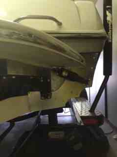

You can create the plates pretty easy or try buy a NSS system if you can for say a 210 or 230. I just added NSS to a 2009 230 finished it about a week ago. Haven't even had time to really get it dialed in yet. The hardest thing was the first couple if holes into transom [emoji16]. I had to raise the swim deck as well to clear the rams.
To control it you can use the lenco switch below. http://lencomarine.com/index.php/pro...tch-kit-single
