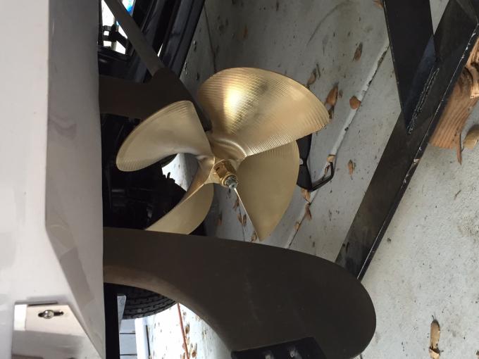

                        Just put the 1939 on my 2013 210 with ZR450. Headed to powell in 1.5 weeks. Will update results when I get back. Hudd, have you been able to use the prop much yet?
                        I also find it interesting that the boat with the 450 comes with a 13.5 prop. My friends 2013 210 with the 409 came stock with a 14 inch (can't remember pitch) prop. Anyone have an idea as to the reason why? Click image for larger version
