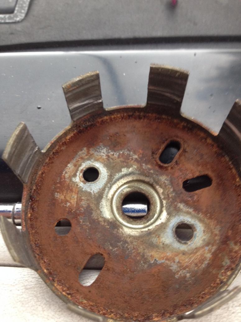

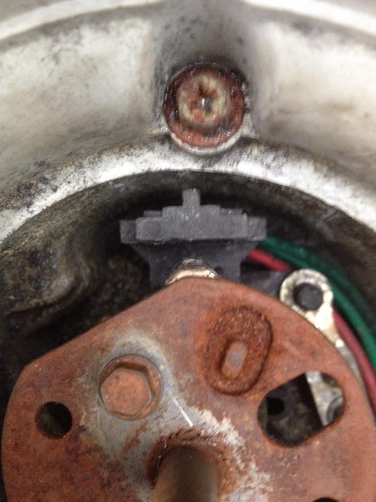

            FIXED!
            Thank you for that SilentSeven. That was 100% what the problem was. You saved me hundreds $$$. Got a rebuild distributor from NAPA for $100 ish. Nautique part would have been $525.
ID:	368697 Click image for larger version
ID:	368698Click image for larger version

              Glad the suggestion worked. Interesting - are those scores on the inside of your hall effect rotor? (last pic) Was there runout in the bearing or was the center shaft in OK condition? Also, how many hours are on your boat?
              Certainly seems to be a pattern that the trigger sensor on these vintage boats is a (more?) common failure point.
