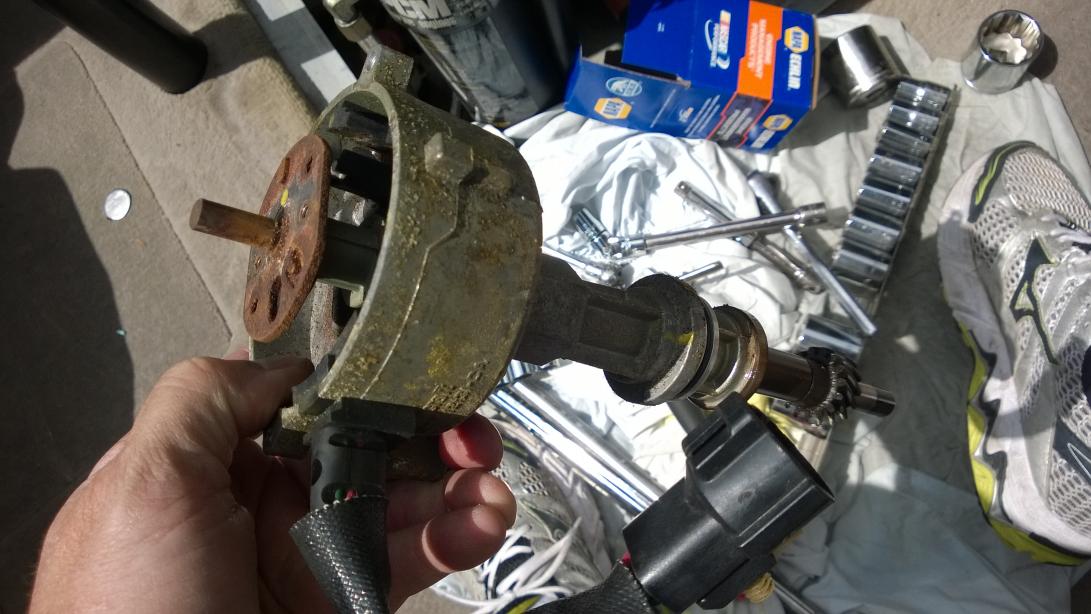

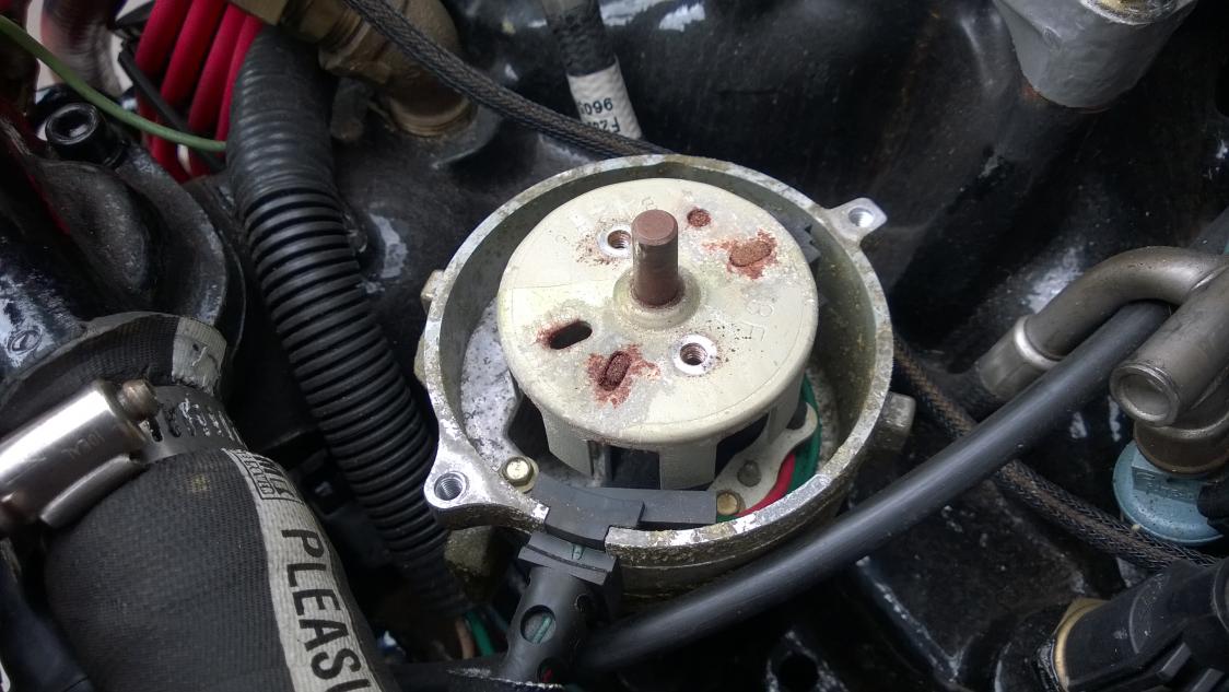

                  Installed a remanufactured distributor over the weekend. Was planning to install a new pickup but removing the cam gear was impossible with the tools available and a reman unit was $90 via NAPA. Ran the boat about 3 hours yesterday in mixed use - idle cruising, towing. Did not have a repeat of the start/stall issue. Started and ran each time. Did continue to experience 'cut out while running' issues. eg - running at some throttle load, boat momentarily cuts out and then immediately continues. Can do just one hiccup or a couple. Feels very much like an ignition cutout. Going to look again at the kill switch shunting wiring and main relays.
                  In general boat ran better with new distributor. Idled better without the slight miss it had before. Internals of the old distributor had some rust on the stator, bolts. No real runout on the shaft. Clearly was the original distributor.

                      Pictures of my distributor with the hall effect sender on and removed. This is the orginal unit. Wiring pigtail looked good, lots of surface rust, very little shaft runout if any.
ID:	368659Click image for larger version
