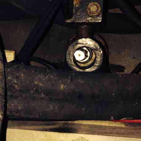

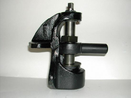

Hi. The top isolator on the middle engine mount of my 08 20 is missing / worn to extinction and was wondering do these rubbers wear out often? Ie should I replace all of them or just the missing one.
The other thing is, I don't have any major vibration at the moment so is a re alignment necessary if I replace just the faulty one? There is a slight vibration on initial take off that goes away quickly that I have passed off as normal boat vibration.
I was thinking I could perhaps let the engine rest on the main engine mount and the v-drive mount while replacing the isolator. But the shaft in the offending mount is hard up against the side of that hole and cannot be pried into place leading me to believe there could be some misalignment as it sits, thoughts?
