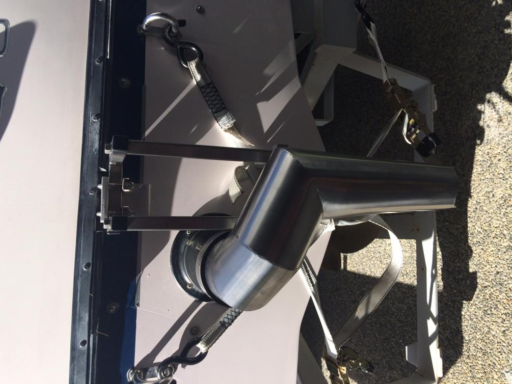

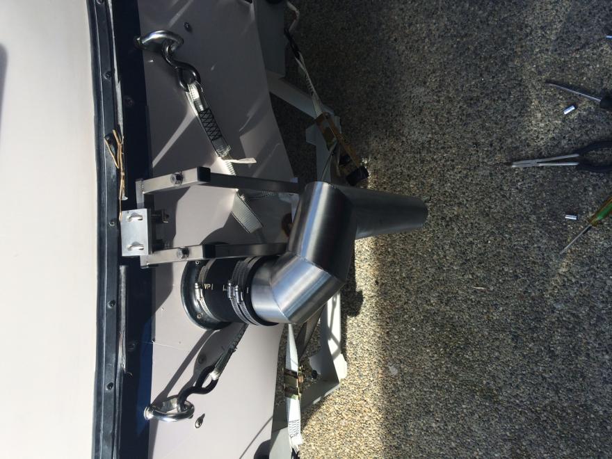

    I tore into the project on Friday morning and it took about 2 hours total, with no major hiccoughs. The instructions were crystal clear, and I totally understand the challenge FAE faces: build a custom product for a boat you can't see or test fit on, and make it easily installable by the consumer. I might have built the support for the pipe differently, but again, I have the luxury and test fitting and having fabricating skills. A nice touch was including a new centre support for my swim grid: much beefier than the old one. Set aside at least two hours for the install, as some drilling and cutting is necessary, but again, the instructions couldn't have been clearer. It may look in the photos like the bracket is off centre and not right, but my centre support is very far left of centre, making the distance between it and the exhaust hole pretty tight.

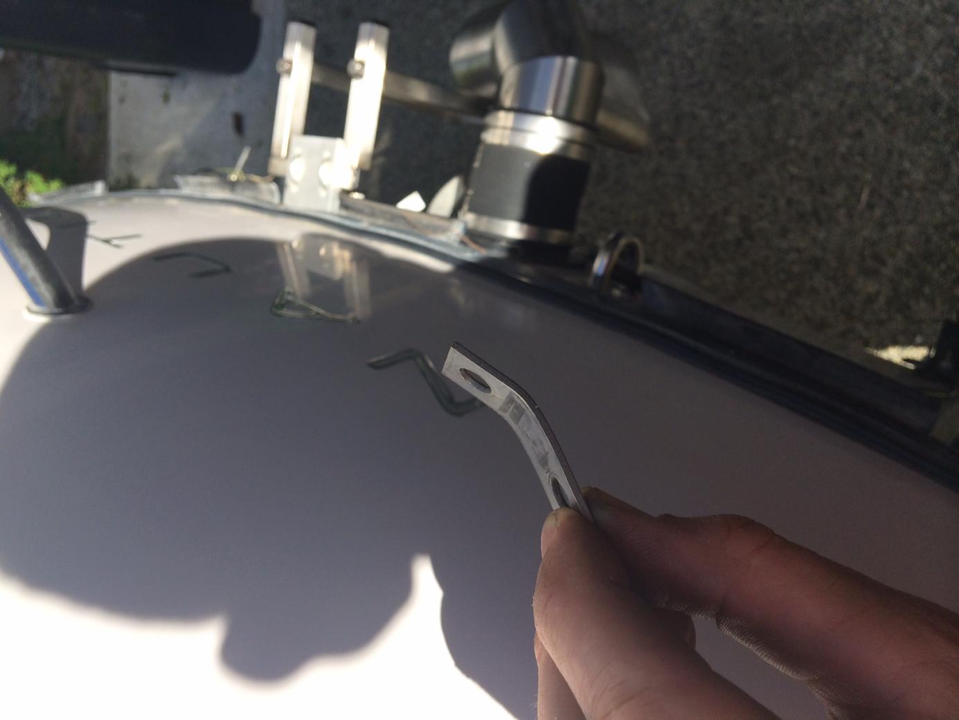

    My one complaint (minor) is the flimsy plates used on the bottom of the u-bolts under the swim grid. As you can see, when torqued down, the plates deflected and with the reduced purchase, the square tubing brace was allowed to rotate slightly under load and the exhaust flex pipe popped off the boat side of things. I solved this by making two new pieces out of the scrap square tubing from the installation. I made two "U" channels by cutting the tubing lengthwise, then drilling it to accept the U-bolts. MUCH stiffer, pipe is way more sturdy and virtually no deflection when the U-bolts were tightened.
    As for performance, it's everything I expected. Huge noise reduction, especially for the surfer, and although I don't have data to back it up, I'm sure reduced CO exposure. It's worth the $420 to not have a 6 litre V8 roaring 8 feet from your face

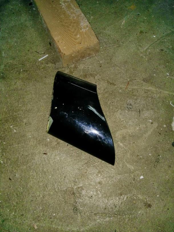

            Quiet but still spraying, 3" cut off the bottom sprays onto swim deck
            I cut it at the same angle as the original using an air cutter. I then ground down and repainted the exposed edge with spray paint from a can (originally powder coated?). Over the years some of the paint on bottom of the exhaust has worn off. The exhaust effect was the same, the boat is quiet and the exhaust blows into the rooster tail and re-emerges somewhere behind the boat behind the surfer. Much better than the swirling accumulation that I had below and massively more quiet than it was even with baffles.
            The big difference was that the spray was now shooting up much steeper and most of it was caught by the swim deck. Still really messy but livable. I will be building a mudflap/tab of some kind to smooth out the mess directly behind the exhaust. I've seen a few of these done on this site.

                  Here's a picture of the bit that was cut off, the original port was curved and the new cut is just angled. I think that the curve is pure aesthetic.

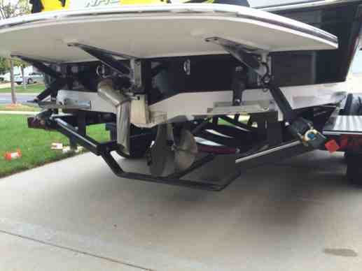

                      Hey Larry I'm really loving my FAE but your comment on making shorter now just wondering what your looking at now for length suggestions? Basically wondering if mine might be alittle longer than need be now? I believe in the past u suggested the pipe extend to about the middle of the prop?Click image for larger version
