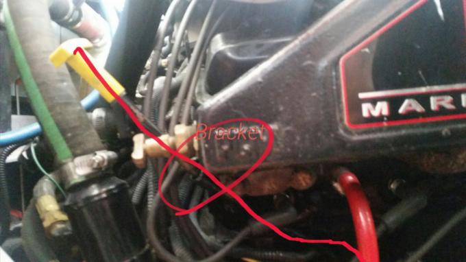

                Do you have a photo of your finished tube? Below is mine from my 03 Air with the 330. I'd like to see what you did.
                Excuse the poor photoshop with red outline of the tube...

                            This pic shows the handle, and the bracket that holds it in place. The tube travels through the bracket and below spark plug #1

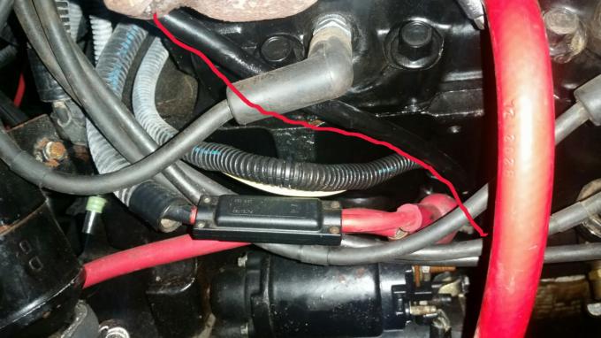

                            This pic shows the tube traveling below plug one and down into the block. It enters the block down by the starter.

                            The tube exits the block, gently curves towards the front of the boat beneath plug #1. After plug #1 it curves back up through the bracket. When I first removed it, the tube traveled outside of plug #1, not under. This was adding the additional plane to the tube that was preventing the flat dipstick to go through the tube.
