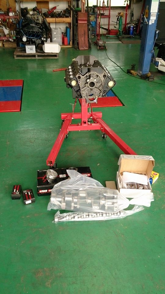

        excalibur 330 to 383 stroker I build
        How did you unlock it? Does mefiburn have marine stroker curves, or did they modify auto ones?

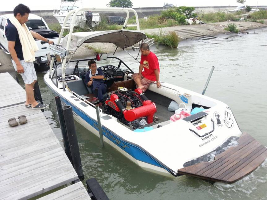

          I am scary using stock calibration.
          Anybody should not use carb so it already have EFI system.
          The ski nautique runs about 40hours, it has no problem.
          I changed spark plug to higher heat range.
          It is more better.
          This motor is good fuel efficient.
          I don't know why anybody do it.
          When rebuild the ex330, anybody should to make the 383 stroker.
          I think so.

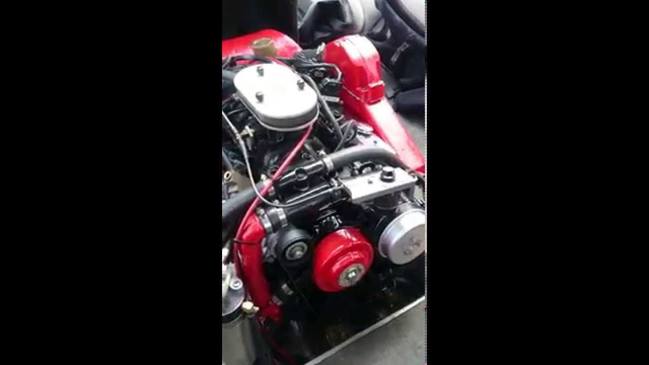

            I have MEFIBURN softwere.
            I checked calibration checksum HEX code and tell them it.
            They recall unlock code.
            Also, I tell engine specification to them, they supply calibration for my engine specs.
            When you send your ECM to them, they rewrite your ECM for you need specs.

                Yes, I can change it by myself.
                If you buy MEFIBURN software, include tune pro software.
                It can be adjusted fuel and spark timing.
                Anyway, I can unlock the MEFI and rewrite it.
                when I try to change some point, the engine was changed.
                I can trust MEFIBURN.com.
                It is up to you whether trust or not.
