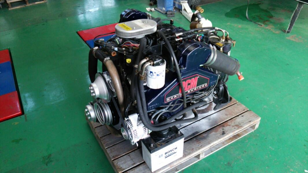

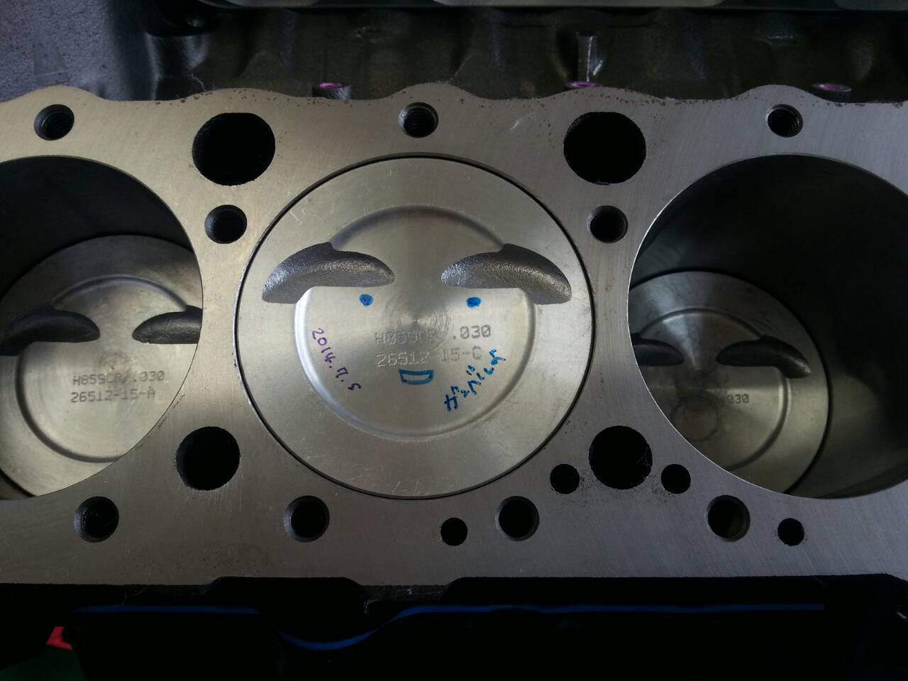

    Hey guys.
    I builded ex330 to 383 stroker.
    I used eagle rotating assembly kit and neutral balance flywheel.
    Also, I use stock MEFI injection system and any other component.
    However, I needed to rewrite the MEFI file.
    It needs exclusive softwere.
    It has power more powerful than ZR450 and ZR409.
    It has around 450hp to 500hp.

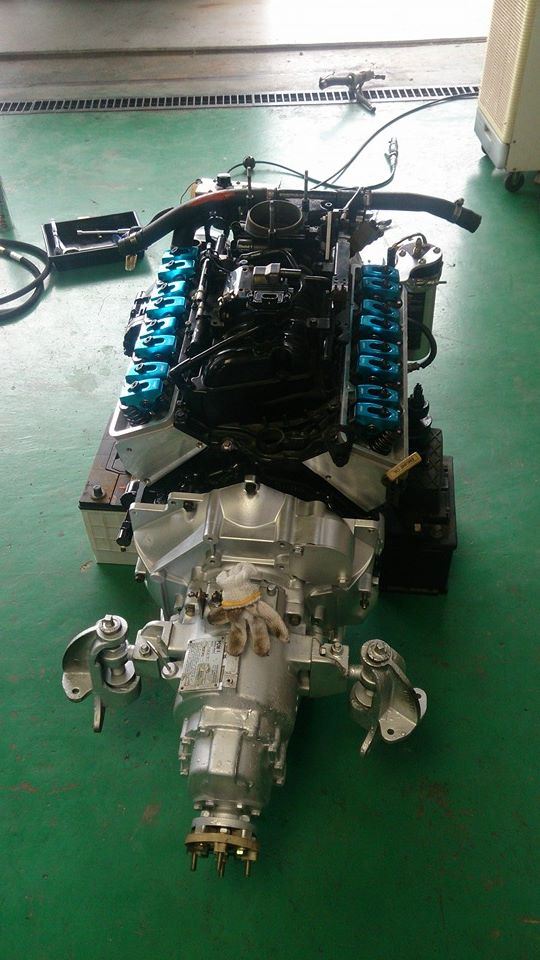

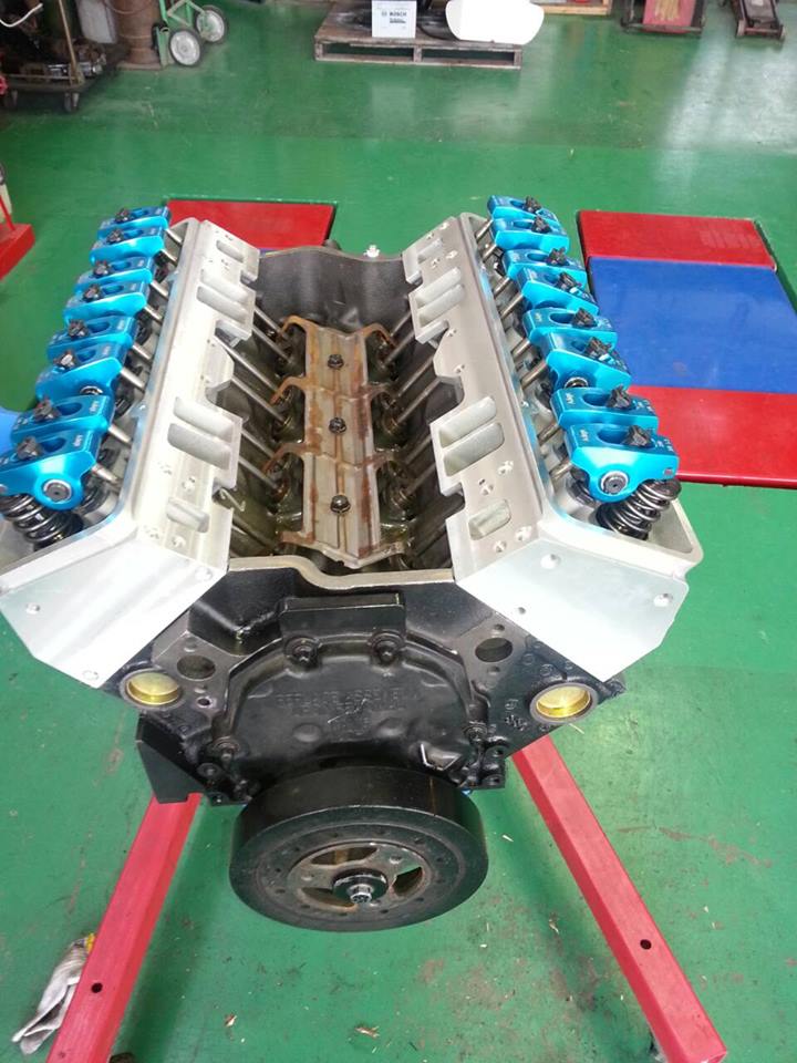

      It has same as automobile custom 383 engine.
      they have around 450-500hp with same specs.
      Also, this engine has larger cam and aluminum heads.
      I have drived ZR450 and owned ZR409.
      This engine have more power than them.
      Stock MEFI has calibration file for 350 engine.
      Also, ZR409's MEFI has calibration file which is different in 350.
      Stock MEFI is not optimized for 383 and larger cam.
      So, I need to be rewrite it for optimize and safety.
      I can acquire more power by optimizing MEFI.
      The 383 engine may run by stock MEFI.
      But, I believe it gives a damage to engine and cannot get a maximum horsepower.

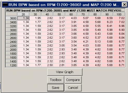

                          I think most here would be interested in hearing how you modified the ecu... Did you unlock it and modify the fuel tables or did you have them start from scratch? Are marine 377/383 tables available or did you use automotive?

                            Yes, I already remapped.
                            this is 330 fuel map in 1200-3600 range.
                            this is 383 fuel map in 1200-3600 range.
                            377ci into 2002 ski nautique.

                              I modified original ecm.
                              I unlocked it and write modified fuel and spark tables.
                              I got 383 and 377 map and softwere from mefiburn.com
                              They can rewrite ecm and send back if you send it to them.
                              If you bought mefiburn program, you can rewrite it by yourself.
