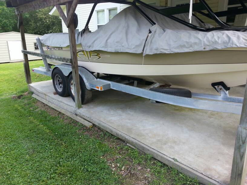

ID:	368505Click image for larger version

                The trailer is a dorsey and says for a sport nautique.

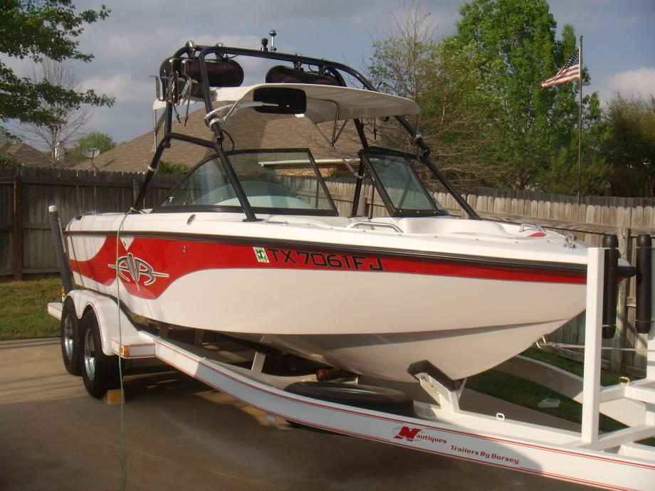

                    Well that explains a lot. I can tell by looking at it that the axles are too far forward. Look at my trailer and how far back the axles are. It is also a Dorsey. The green one was a 98 super sport that I had a few years ago.

                      That is definitely not the best trailer for that boat...
