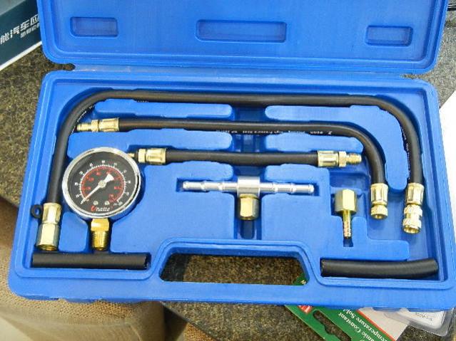

2 ) fuel rail and fuel cell ,has gasoline splash,fuel press looks like normal ,
