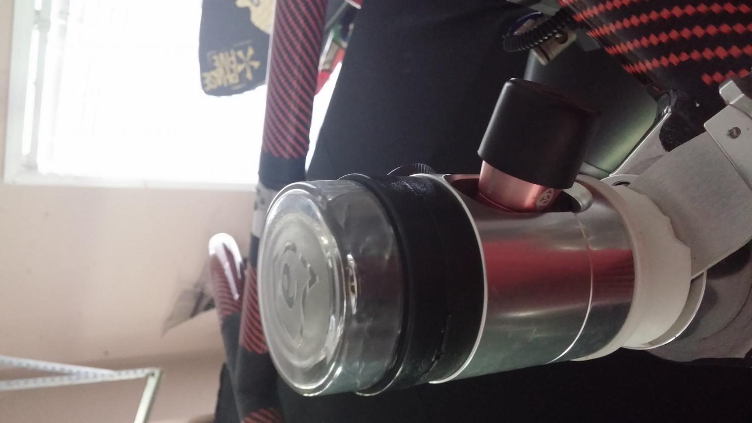

    My 230 has a FCT2 Titan tower on it, and it has a tower camera. I'm not sure if this was a factory option or not but the light on top does not work.
    This is the light and camera. I can't seem to get the light off of the camera. Any help?

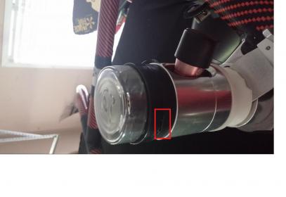

    This is a total guess but do you stick a screwdriver in the spot I highlighted and pry the two sides apart?Click image for larger version

      I've thought about that but worried I was going to damage it. I am at a total loss with this, because I dont think this was a factory option. I think the previous owner installed this camera.

        I took a guess that was an Attwood piece from the marking on the lens and was correct. Product info below. Install instructions say the lens unscrews from the base to access the light. It is an LED so you may just have to replace the unit.
        http://www.attwoodmarine.com/store/product/5580
        Jason
        All black 2003 SANTE

          Perry you might want to check the wiring to make sure it is getting power before replacing. Those LEDs should last a very long time before needing replacement.

            I am defnitely gonna check the wiring because the camera does not work either.
