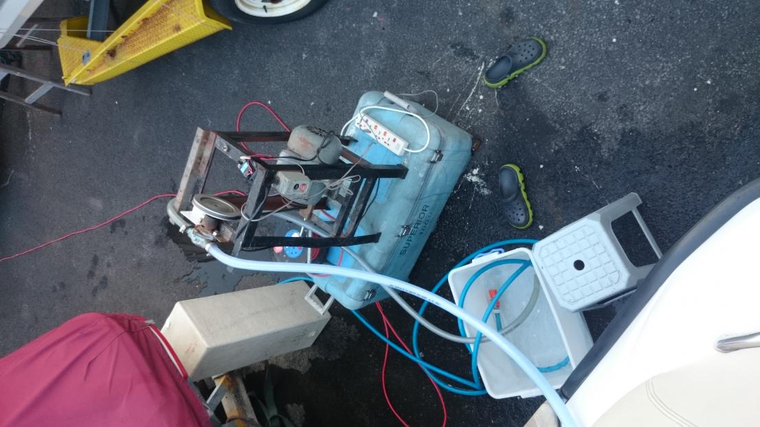

          *for inspecting and ensure enough water flow to cooling necessity without putting the boat to sea for testing,I run the raw pump with a motor bench externally,

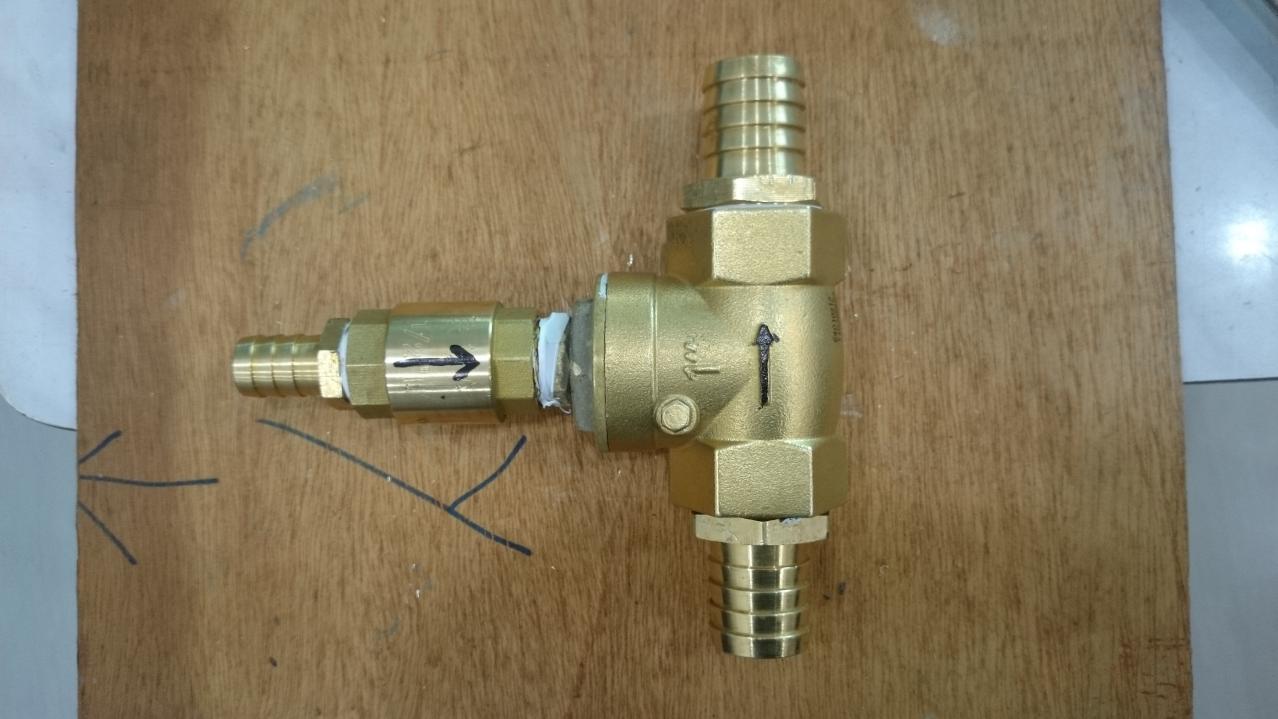

          *had suspect the stock through hull flush setting,I replace it with a set up like this.

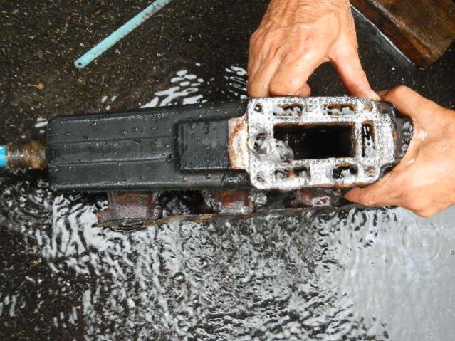

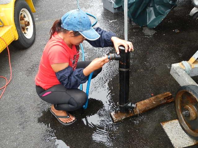

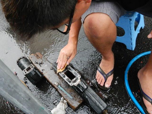

            Today takeout the riser,manifold and heat exchanger,no significant problem found,remove rust bud build in the the water passage of riser and manifold ,flush out some dirt from the heat exchanger,put it back, test to water, , cruising about 20 minutes,the symptom much reduced! better in higher RPM,in idle feel a bit hot, next day will have look on the oil cooler, what should be the temperature of the heat exchanger ? its hot when I touch, similar to the fresh water coolant tank.

              Sounds like the risers and manifolds were at least part of your problem. If it is running the proper temperature at speed but heating up at idle that usually means there is an air leak somewhere. I know that is true with a raw water cooled system so I would think the same holds true for a closed cooled system like you have. I know you mentioned that you checked all connections for air leaks but I would check each one again. Use a nut-driver instead of a screwdriver to make sure that the clamps are tight. Also check that the strainer gasket is in place and the strainer is tight. If any of those hoses are dried and cracked you may want to replace them because even a small pin hole could cause it to not cool properly at idle.

                The over heat issue can say solved after flush and rust remove the related sea water passage elements :heat exchanger,riser,manifold, but don't found any element has obvious problem,but on these actions,all the house clamps are re tighted.
