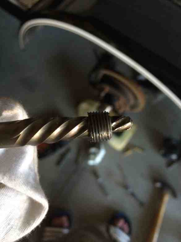

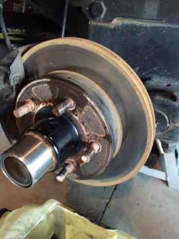

    Ok changing my hub oil and had some issues with the plug. Basically rounded the darn Allen out and had to use an easy out. I'm not 100% sure a filling didn't get inside so I'd like to pull the hub to make sure but tell how in the world these come off. Anyone offer some help? Thanks Click image for larger version

    To remove a pressed in hub, I've done the following:
    Gentle approach: use a rubber mallet and knock it carefully back and forth side to side until it wiggles out.
    Less gentle approach: Use a big-*** pair of channel locks, grab that b*st*rd and shove it side to side until it wiggles out
    Good luck with that...

      Silent, I was afraid that was the only way. But I was hoping that maybe these caps screwed on.
      If I manage to pop the cap off what are the odds that I will be able to get it to seal good again?

        Unless it's something different than what I have seen, they all press into the hub. You can generally re-use the buddy if you can get them out without bending the barrel. Some seem to come out nicely, some not so much.
        If you do re-use it, just make sure you check it after driving a few miles. Typically, if they are not going to stay in, they fall out pretty quickly.
        I can typically re-use mine without issue but there's that odd one that just seems to want to fight you.

          Hit it with a hammer gently and keep hitting until it comes off. It is pressed on. There is a great little tool that you can use to reattach the cover back on the hub. When it gets too warped to go back on just buy new ones. The trailer store in my area sells them for $1.75/ea.

                  Thanks for the help guys! I got the end cap off with the rubber mallet. Just like silent some whacks with the mallet while rotating hub worked it right off. Cleaned out the oil and found a couple bits of metal so glad I did this. Used rubber mallet to work the cap back on, filled with oil and all is good again.
