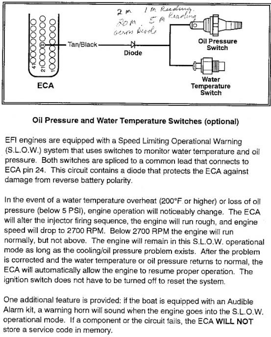

          That 2700rpm sounds like the SLOW (Speed Limiting Operational Warning) or "limp mode" is kicking in.
          There is a separate oil and temp switches that activate this mode on the ECM for the GT40.
