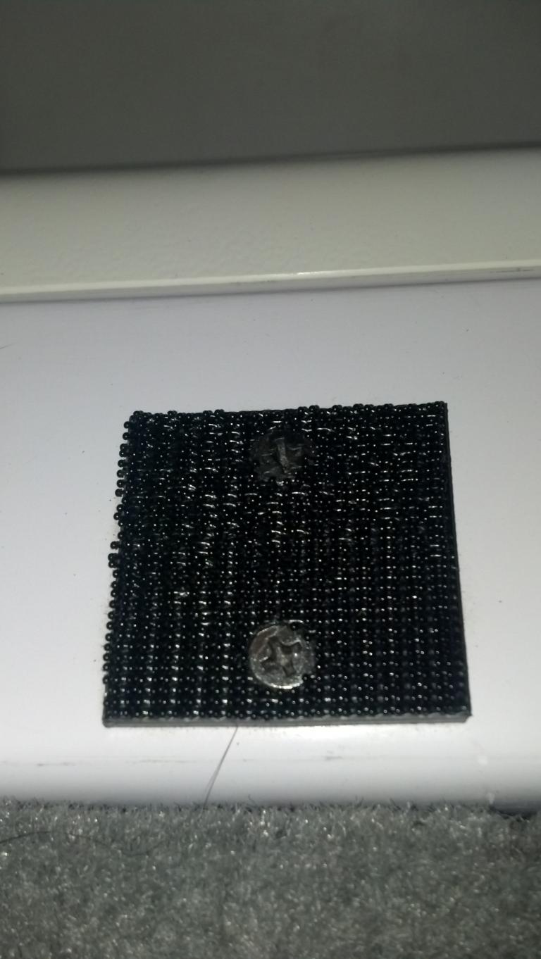

ID:	368316So after I installed the new hard, black velcro tabs I can see deformation after only a couple of uses. I need to remove the starboard rear cushion bottom to access my battery switch, so it will be used often. It takes quite a bit of force to slam the two pieces together so that they fully engage (I always feel with my hand to make sure they are lined up properly). It also requires a lot of force to pull apart. I cannot imagine that these will last very long based on the amount of deformation that has happened so quickly. I was hoping someone came up with a improved replacement that will last longer than 1 season.

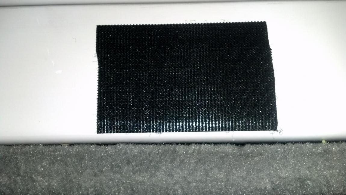

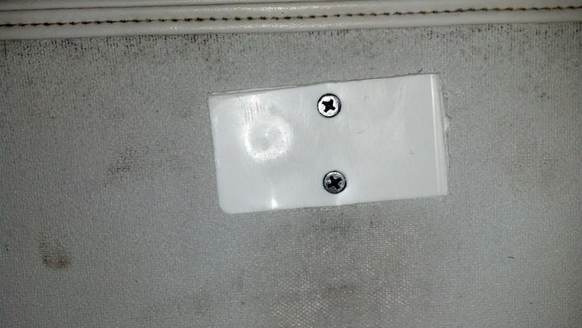

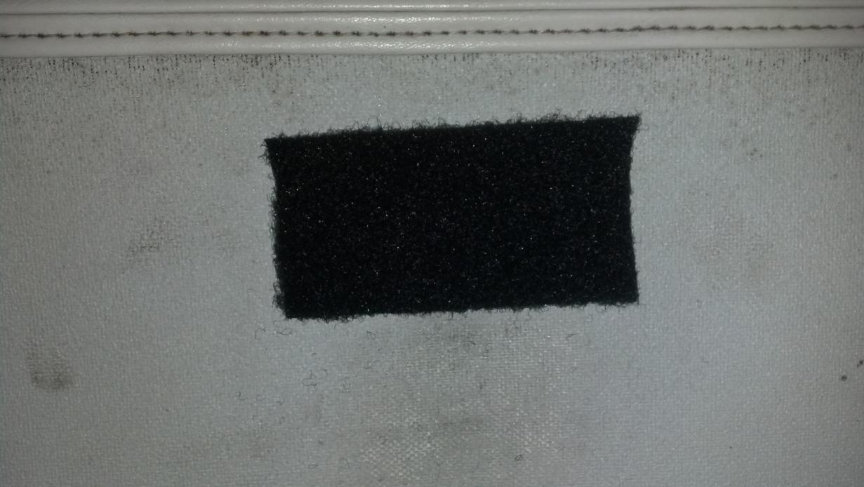

                              That looks great. On my boat the lower portion of the seat is fiberglass, so I just cleaned and stuck the hook velcro to that surface. I found some hard plastic laying around the house and cut it into strips, drilled the same hole pattern as the original hard black velcro squares. Here is a picture of the velcro I used:

                              Here is a picture of the hard plastic strips screwed to the bottom of the seat cushion (my velcro stated that is was not recommended to stick on fabric and the bottom of the seat cushion is wrapped in some type of fabric).
Name:	Hard White Plastic.jpg

                              Here is a picture of the loop side of the velcro adhered to the hard plastic that is screwed to the bottom of the seat cushion.
Name:	Loop Side stuck on White Velcro.jpg
                              Here is a picture of the hook side of the velcro adhered to the fiberglass seat bottom.
Name:	Hook Side stuck on fiberglass seat bottom.jpg
                              I made my loop side a bit smaller than the hook side, but after the job I think I should have made the hook side a little smaller than the loop side. I think that the cut edges of the loop side may come loose over time and clog the hook side, but I do not think that will happen for years. When it does, I will have 3'8" left of 4' long strip of velcro I bought. When I put the cushion down, I wiggle it back and forth a bit to really get the hooks to engage the loops. This seems to hold very well. I think I paid $8 for the 4' strip of industrial strength of velcro.
