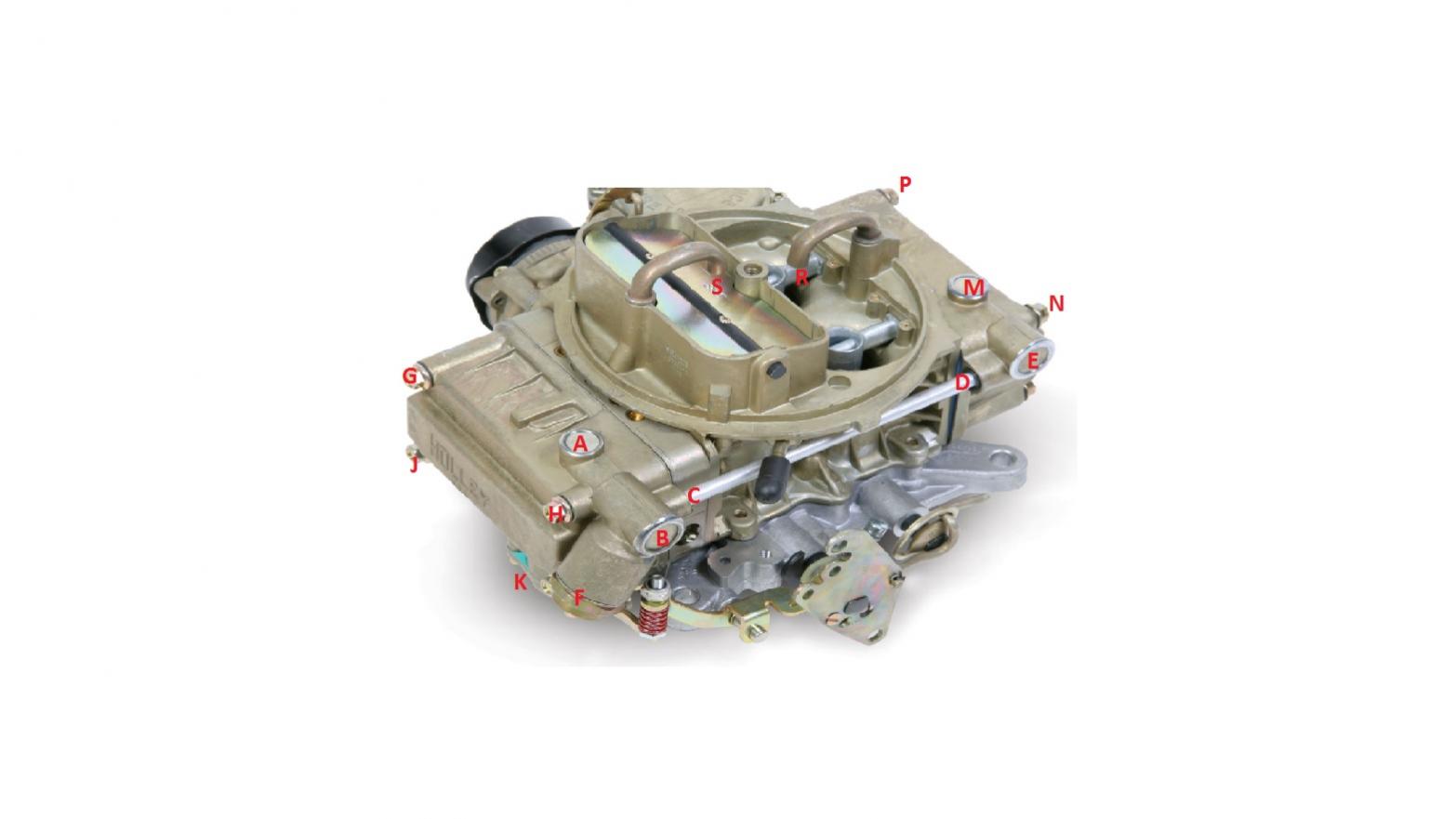

When I tried to start the boat for the first time, I had fuel everywhere...on top of the intake and in the bilge. It took me about a minute of panic and another minute of trouble shooting to find the leak. It is leaking from the carb where the fuel line goes into the primary and also slightly leaking from the secondary. It is leaking on the side of the carb where it looks like there is some sealant covering the round end where the fuel lines meet the primary and secondary. It looks like they were sealed with some sort of sealant. It is NOT leaking from the fuel line or where the fuel line connects to the primary. The fuel leaks right above where the fuel line feeds the primary. The fuel followed the fuel line down to the fuel pump and that is how it got into the bilge.
Is sealant around there normal? Web pictures of a factory (non-marine) carb show different options; covers, bolts, etc. I don't have the time to link a photo or grab a photo at this moment. I was hoping my description was ok and people would understand.
After some more looking, these have been leaking for a while due to the stains on the intake manifold. Strangely, it leaks when you are cranking the motor. If the motor does not start, the fuel goes everywhere. When it is running, the fuel does not really leak out (not really is not safe, and it will be addressed). I'm guessing it leaks like that when the motor is not running because there is no venturi affect to pull the fuel into the intake??? I would think it would leak all the time.
This carb was rebuilt about 2 years ago. Looks like I am going to have to pull it and rebuild it now.
Any info about the sealant or the type of leak would be appreciated.
