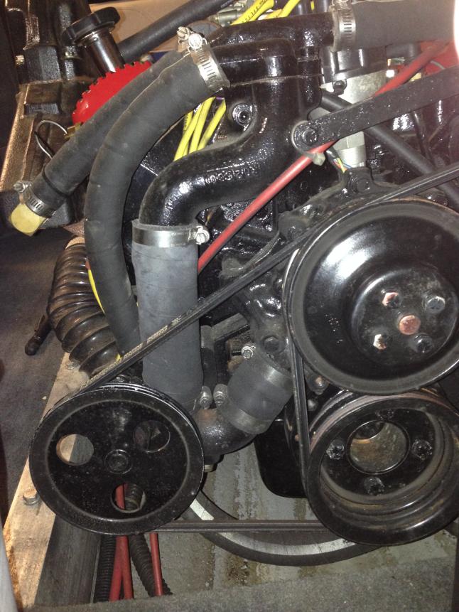

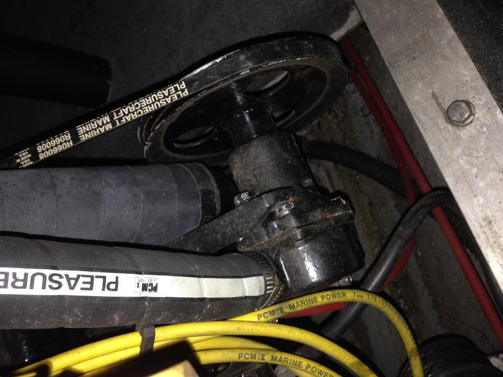

Thats it . Two 1/2'' mounting bolts remove the complete unit . MARK the two halves of the housing then remove the three 7/16 bolts holding the two haves together. NOTE the pump assb can be installed upside down if that occurs it will not pump water . Either mark it before you remove it or remember the two hoses are on the engine side
That should be a simple 15 minute job. May take you a little longer on your first go-around. Man do I miss how easy it is to do an impeller replacement on a GT40. My Apex is a royal PITA!!2002 Ski Nautique 5.7 GM Apex
