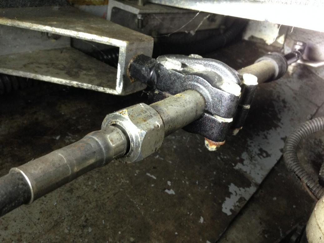

    Hey everybody today while pulling the boat out I noticed that my steering wheel was really tight. So I decided to troubleshoot. I disconnected the link from the rudder and it was still tight. So then I pulled the bar off from the steering rack and the wheel is free as can be. Do I need to replace the steering cable? or is there a way to grease it? I also found that the rudder by itself was a little gritty feeling when i pulled it one way and free the other. Is there a way to lube the rudder shaft?? And one other the brace that holds the cable right before the rudder has some up and down play is that normal??? Hopefully the pics work. Please help Thank you

          Replace the cable. In your first photo above, you can see the clamp holding the tube at the rudder-end of the cable. Do not loosen or remove those bolts. You just unscrew the cable from this tube. All you should need is a pair of fairly large channel-locks on the big nut at the end of the cable.
