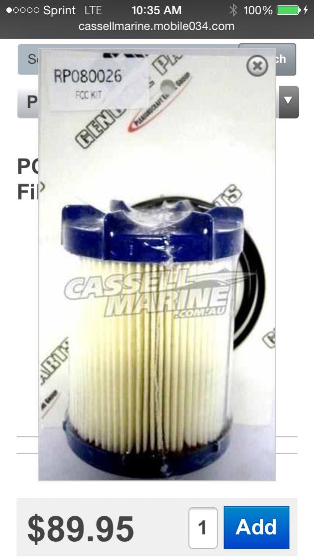

              I'd love to find a cross over fuel filter because paying over $40 for the crappy little paper filter is crazy!!!
                Assuming that you have the remote oil filter I think it can use the Motorcraft FL1-A or any equivalent. I know it sounds weird to put a Ford filter on a Chevy but I think PCM has always set up the remote filters to use the FL1-A.
                Sorry I just realized you said fuel filter, not oil filter. It would be great to find a cross over automotive part for that.
                  I'm talking about a after market for this sucker:

                    Ya sorry I re-read your post right after I submitted it and saw that you had said fuel filter. You must have been in the middle of posting when I finished editing my post.
