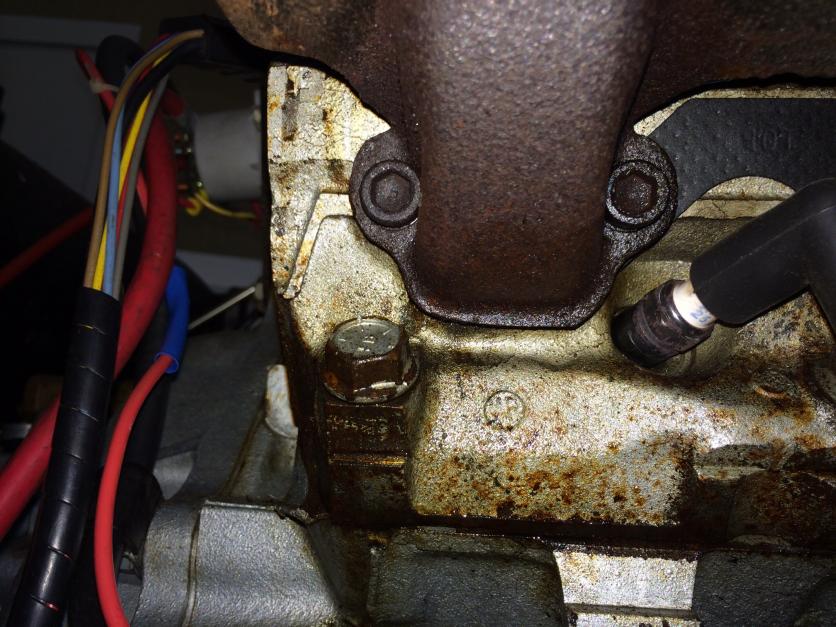

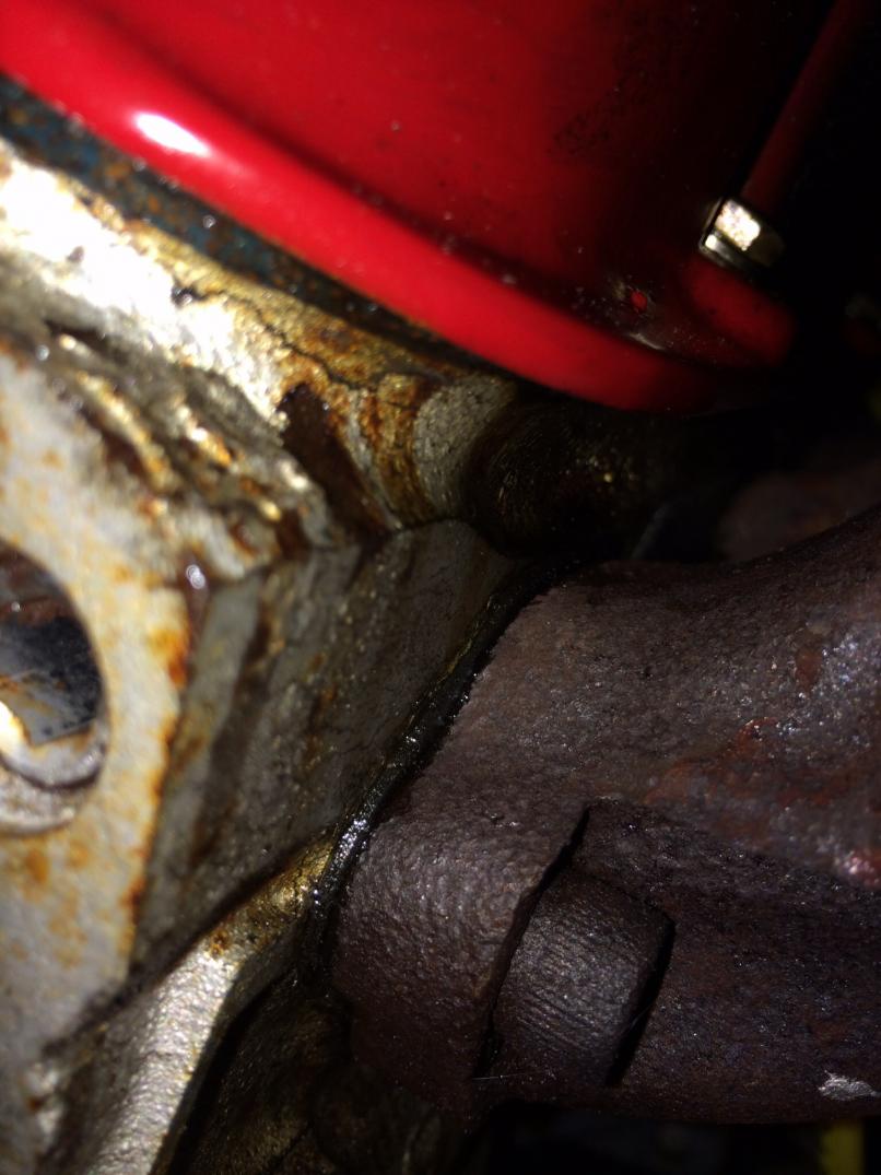

        I am guessing it is leaking a little oil and it is running down the valve cover to the back corner then leaking onto the hot part of the exhaust manifold runners. It takes a surprisingly long amount of time for even a little bit of oil to burn completely off. Very common if it has cork gaskets for the valve cover bolts to back out enough to cause a small leak. Tightening the cork gaskets on my boat is a yearly thing.

            Thanks everyone for the help. I think/hope Zach is right. I looked around with a flash light and there is a little oil on the exhaust manifold. I took some pictures. I'm going to make sure the valve cover bolts are tight and crank it up later this week. I'll let ya'll know.

                You can get the valve cover off for replacement without taking the exhaust manifold off. Get a 1/4 drive with a swivel and preferably a deep well socket. You can probably pick up a set of rubber gaskets for it down at any local parts store. You can crank the cast valve covers down a little tighter on cork gaskets as opposed to stamped gaskets but be careful not to over tighten and crack the casting. That is if you have to replace it. Probably an hour job for a first timer and 20 bucks for parts store gaskets? The deep well socket puts the swivel at the top of the valve cover, a long screwdriver also helps to get the socket on the bolts behind the exhaust manifolds.

                    I've run the engine a few more times when I changed the oil and transmission fluid. No more signs of any smoke or leaking oil. I think the problem was just a little oil leaked from the valve cover over the winter. I'm not going to change the valve cover gaskets until this is a bigger deal.
