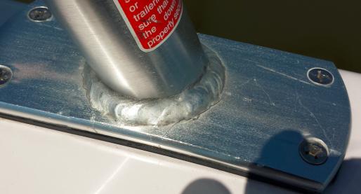

                        Here is my pickle off my 2005 SANTE. My guess the tower swayed pretty hard at some point for it pull like that. I guess I need to pull the lower tower mount off and have it welded.

                          ^^^^I would try to get a new base/pad and get it welded on.

                            Finally got around to taking the rear leg off my tower. Brought it into a guy that does aluminum welding and he did an awesome job straighting the plate, then welding the fractures top and bottom. I forget the type of weld that came from factory, but he said the type of weld he put on is stronger. He said cutting the plate off and doing it again would be very hard to match the height, angle, etc.
                            Getting the leg off/on take some time and you need an extra set of hands to hold the screws while someone ratchets the nuts off the bases underneath. Since I was doing this work, I checked all the bolts on the port side tower leg and sure enough, the front leg bolts were fairly loose! you could not tell just by looking at it from the deck, but if I were you and have a similar tower, check all your bolts. Even though they have lock-nuts on it, they bolts were loose. Crazy.
