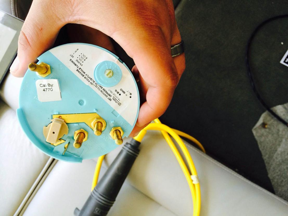

    Here is the kit I got:
    a-32-1007a b FARIA CONVERSION KIT (PERFECT PASS SE JUMPER WIRE)(BLK/BLK) replaces 00-01 gauges

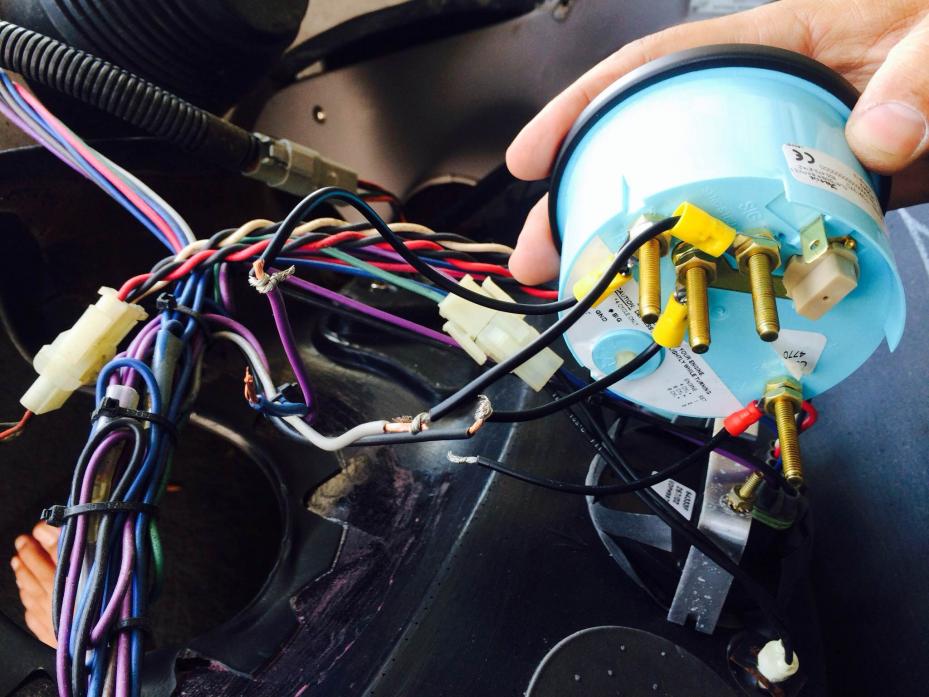

    The first thing I did was the tachometer. This was pretty successful except it took me a little while to figure out which wire went where. The Teleflex gauges have the wires into a plug that then just plugs into the gauge. The Faria does not. So I cut the plug off and started playing with the wires a little bit with a volt meter to figure out what was what. To save others time here something I learned along the way which was a major headache for me and I wish I could have found. Black is the ground. Purple is the power (battery). Silver is the signal, and blue is the backlight. This information would have saved me a ton of time and besides figuring that out, it was a very simple switch. Check out the attached pics to see what I did... the wiring was just temporary to make sure it worked. Once it was all working I clamped them down with marine clamps and heat shrunk it all down.
    So then on to the speedometer. Learning from the Tachometer, I cut the plug off (mistake 1) and saw a purple, blue and black wire. I assumed these were the same items as above and I still believe I am correct, however there was then 4 more wires. I was thinking these were the signal wires from the back, but after more research and looking around online I think these do not give the correct type of signal since Faria is looking for a paddle wheel, and not the pressure system that is standard on a 2000 Super Air Nautique. I also noticed the conversion kit even says Perfect Pass SE jumper wire, so I am pretty sure at this point this only works with a paddle wheel (which I have no intention of installing). I put this in bold so hopefully I save someone the trouble that I went through today.
    My next item on the agenda is to just buy perfect pass with the gps speedo, so I am not really that concerned. I have a good tachometer now and will just use the PP as a speedo.
    So my question is this... when I was testing the Speedo and trying to figure out the signal that was never going to work (yay me), I blew something. I think some wires may have touched that shouldn't have and now my boat has no power. Here are the things I have checked so far and I am wondering what I am missing:
