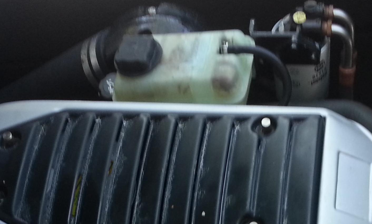

    Last time we went out I noticed alot of build up in the coolant reservoir. Does anyone know where this substance could be coming from?

    Any chance some of the wrong coolant has been mixed in?

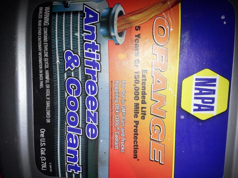

      The boat was a demo boat before I owned it. I think they knew the correct coolant to put in. When we bought the boat from the dealership this summer, they gave us some additional coolant to add in case there was some air left over in the lines from a valve job they did. Heres what they gave us.Click image for larger version
      The manual says ethylene glycol so I think thats the right stuff. I have heard of people adding the green stuff to this and it basically all turns to sludge.

        Also the stuff on my finger isnt just from dipping it in the coolant, it's what I wiped off the inside wall of the reservoir.

          If it's a different coolant from the GM product, would highly suggest getting some professional assistance as mixing will gunk up the cooling system.

            It says its for GM motors that use DEX-COOL.

              If you are not getting water in the oil there is a good chance its just the coolant starting to fail.
              I have had a fair number of vehicles with dex-cool in it and no matter how well I maintained the coolant some of them eventually gummed up and looked like that, and eventually they all get flushed and replaced with normal coolant. I have heard that it could be air, or some contaminate such as normal antifreeze or oil or sealant or something in tap water that got in the coolant and is causing it to degrade and start to sludge up.
              Since it looks like a good system flush is in order if it were my boat I wouldn't refill it with dex-cool. If it were warm enough I would drain and flush the system and then run distilled water in it for a while and drain then refill with a normal coolant that claims to be compatible with dex-cool for the first refill and then keep an eye on it for a while.
