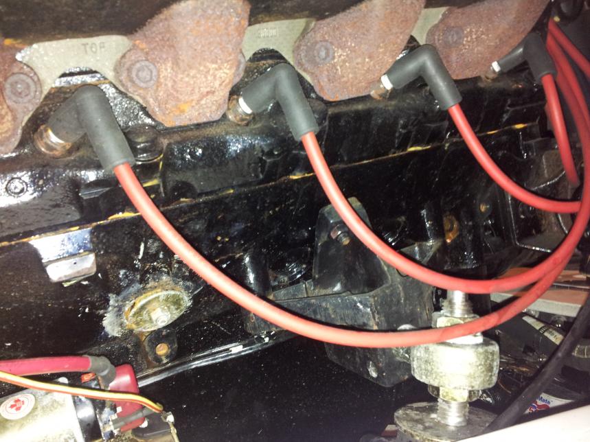

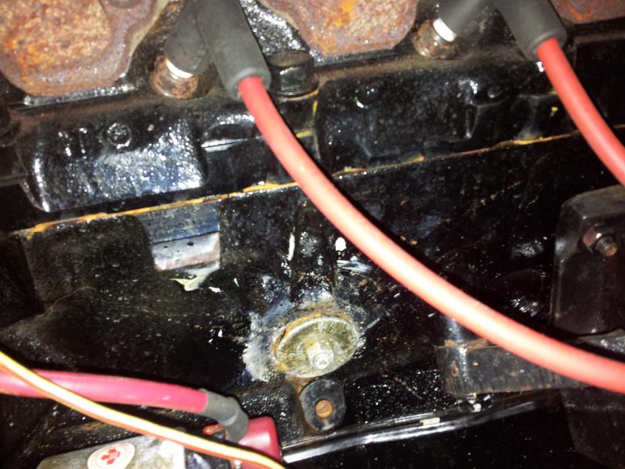

    on drivers side i drained closest to the belts but there seems to be a second drain on that side located on the block above the starter? looks as thought it is a drain also given the rust around it .... do i drain this also ? any help is much appreciated for this is my fist winterization. thanks

    That is not a drain, that is a rubber aftermarket plug that was installed in place of one of the original casting plugs. It does go into a water jacket, but that nut is whats holding tension on the plug, and is not a drain. I would recommend leaving it alone.

      thanks TRBenj ! will leave alone . am i correct also to leave all drain plugs all out for the winter after draining the antifreeze i cycled through to make sure no water left ?

        If you are storing it dry make sure you angle the nose of the boat down to get the water that sits right there by that plug out. The previous owner probably didn't get all the water out of that small corner at one point and it popped the rear plug out. That or he knew about the small amount of water that hides there (some dumb reason ford put that block drain at the front of the engine ) and installed that to drain that remaining water from the corner. I have popped my freeze plug out back there once but the nose down procedure produces no plug popping.

              I dont like leaving the plugs out because the threads rust up and strip/break easier. As far as freeze protection goes, youre covered though. I have never had to put the nose of the boat up or down to get all the water out... Im guessing Zach may have had a partially clogged drain or something that prevented it all from getting out, causing it to pop a casting plug.
              Just so its clear, you should be doing the following, in this order:
              1. Drain water
              2. Backfill with antifreeze (optional)
              It sounds like you may have sucked up antifreeze before draining anything, which is just a waste of money.
