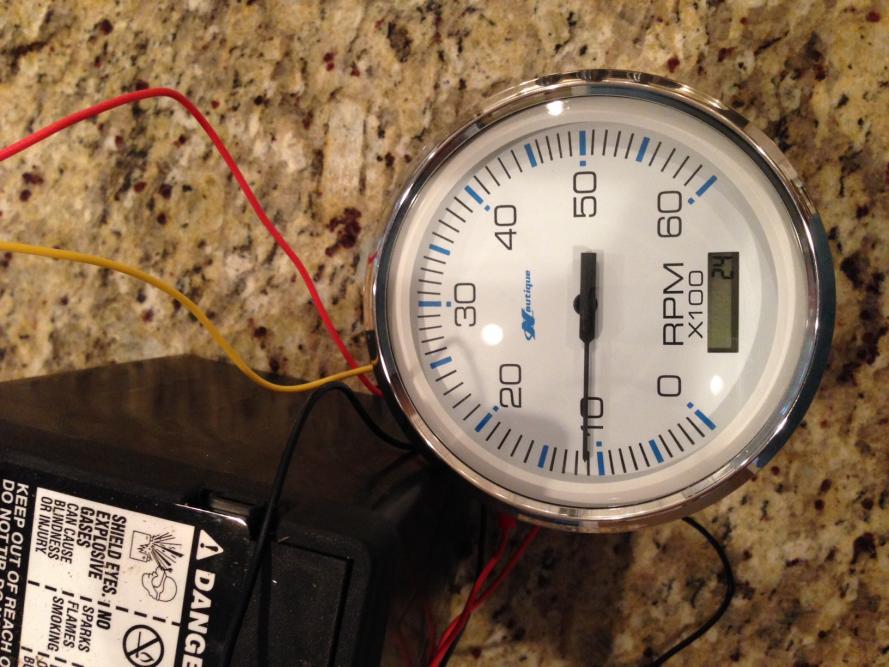

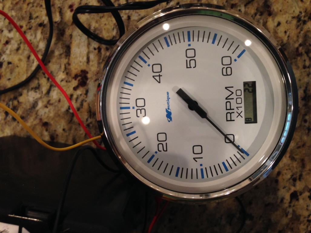

    Replaced the tach on my 04 SN196, needed to add 800 hours to make it correct.

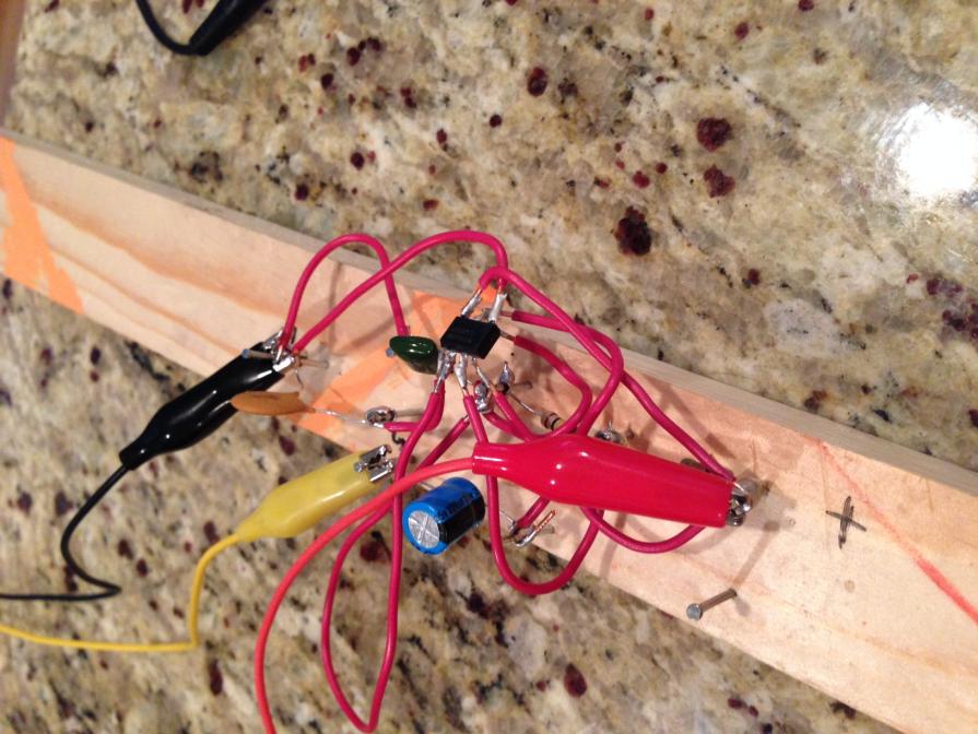

    i made this signal generator and it actually works. Now I just have to wait 33 days for it to be correct.
    Thought someone here might find this interesting. Used a 12V battery from my lawn mower with a trickle charger, a few capacitors, resistors, and an IC. Generates a signal which my tach interprets to be idle RPM.
