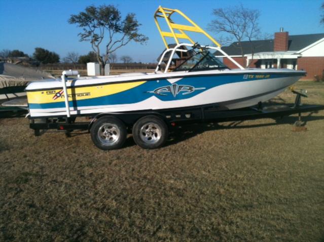

Hi, I just got a craigslist special boat and I have a lot of questions. I bought it not knowing much about Nautiques, but being a long time skier and sufferer of wooden boat parts -they had me at 'no wood'. First, does anyone use a single axle trailer with a boat like this? The double axle is much harder to navigate my cramped driveway with than my single axle boat, I'm hoping to find someone with a single that wants a double. I keep seeing acronyms describing peoples boat and don't really know what to call this, its a 21' direct drive "air"? Also, does the speedometer working but the lcd breaking up mean I have the standard problem I'm reading about and need to go analog?
2000 or 2001 air Nautique is what you have. Good boat. Yes, your gauges are going bad. Do you have perfect pass?Now
2000 SAN
Previously
1999 Air Nautique
1996 Tige Pre-2000
To the OP, that's an "Air Nautique" but, technically know as a "Sport Nautique." If your boat also has the ballast tanks in the trunk then it's an "Air" version.
The LCD gauges will need to be replaced. Try to take note of the hours on the tach before you replace them...2008 230 TE-ZR6

yes, it has perfect pass - I don't know what different kinds there are. I was pushing the buttons on it and it was bringing up speeds for kneeboard/wakeboard/slalom and stickers on the windshield say 'PerfectPass'. Do you know what two arrow buttons near the starter button do? It has two built in water tanks and dials and buttons to fill/drain them but I have not gotten into that yet (water is low 70's already so I'm done for the year). Only 297hrs so I will transfer that to new gauges. Do you know the name/number of the gauges or do I need to just buy them from dealer?Ken
2001 DD Air GT40
These are the gauges you need. Use the discount code PND for 10% off.
http://www.nautiqueparts.com/fariaga...blkgauges.aspxPlease do not PM me directly asking for advice on how to repair your boat. While I would love to help everyone, I simply do not have time to respond to all of the inquiries. Please post your questions on the forum, so that all of our members have a chance to answer.
