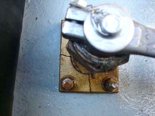

    I see things like this as something that's just waiting to bite you in the ***. Personally, I can't see how anyone would think it would be better to wait until it fails
    I would love to know exactly what the presumed "failure" would be that would "bite you in the ***". Im a preventative maintenance guy too, but this isnt a cracked head or a degraded steering cable here. Its a non-load bearing, non-sealing backing plate- a glorified fender washer.
    Not that Im against swapping out the backing plate if its cheap enough and gives you peace of mind. But replacing the entire $250 port because of this is just silly.

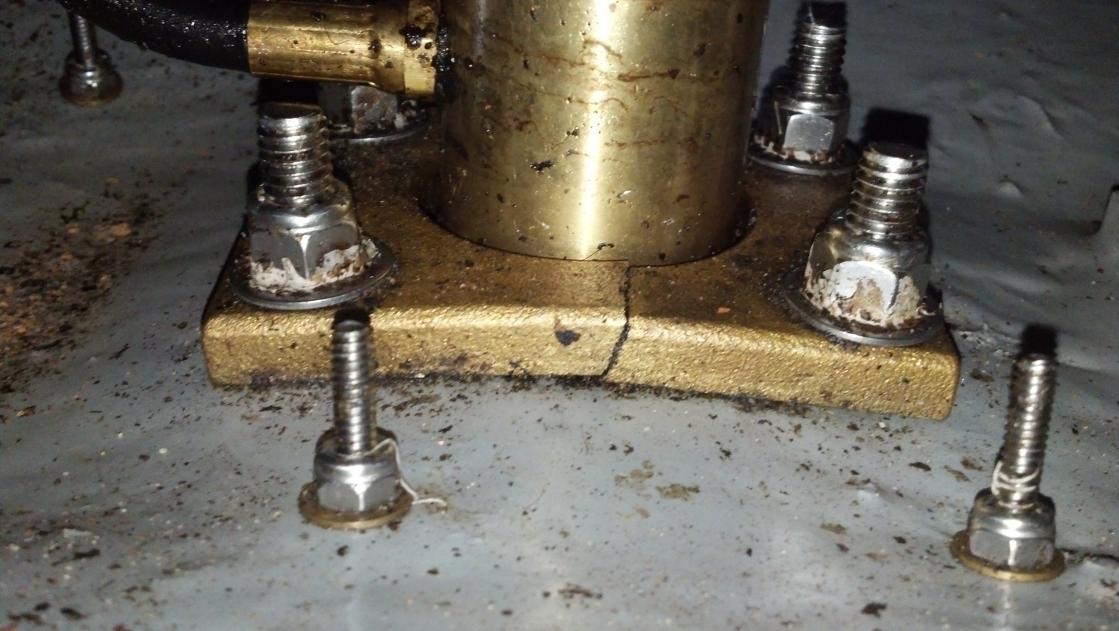

      We had the exact same cracks in one of our 05 196's rudder ports. Our dealer talked to Correct Craft and the failure was blamed on a bad casting and replaced under warranty. I will see if I can find the pictures and post them.

        I am telling you its because the bed that the piece sits on is not a 100% flat surface. Doesn't matter how good the casting is cast metal does not bend... Hence cracked blocks when un winterized.

          05 rudder port
          Cracked 05 rudder port.

ID:	367515Here is a side view of my backing plate. You can see the curvature of the hull. A new backing plate would show cracks within the first two seasons.

              Ours was cracked we suspect from day 1. This was a club boat and once it was broken in we pulled everything to check bolts, screws etc. and that is when we found it. I am guessing a little too much torque on the impact at installation.
                I'm not presuming anything. I'm saying it's cracked and that's just not something I want in my boat. If you're cool with leaving your boat this way, by all means please go forth and do.
                Hypothetically, I could see where this crack could allow something to move out of place and bind the rudder. Or perhaps in a tight turn this crack shifts the load from where it was intended over to the fiberglass in the hull and starts a crack there.
                Regardless, I'm not leaving MY boat that way. I've owned one boat or another now for more than 30 years. I developed a discipline around fixing small problems before they become big problems and it's served me quite well. Your mileage may vary.
                  This is generally correct (although I know of casting material stronger than the glass LOL).
                  When I close my eyes....I think I can see the cracks in mine, too.
                  They are fine the way they are ...but what they need is the washer to be machined out of plate and it be somewhat thinner so it can flex over that glass. Several thin ones stacked might be a good idea also.
                  I will say though....that if anyone takes theirs apart, have a new one ready. I bet it's not fun to put the cracked one back in correctly...although I'm sure its possible.

                    Agreed for a non flat surface a plate would be better than a cast piece. Apples to apples. Generally the older boats don't crack because there is a flat piece of wood between the hull and the cast piece.
                      The statement below sure sounds like a presumption to me.
                      And therein lies the problem. The above statement indicates a clear misunderstanding how the rudder and port work. There is no credible scenario that I can think of that would cause binding. Cracks? Maybe. But that is a very serious stretch based on the damage thats been presented in this thread.
                      Preventative maintenance is all well and good, and fixing small problems before they turn into big ones is a good practice. That said, claiming that a $250 rudder port is the required prescribed fix for the aforementioned cracks in the backing plate is like saying "fix that gelcoat chip or your boat will sink". Yes, it is an imperfection, but it is one that is not going to have any appreciable effect on the performance or reliability of the boat.
                      Yes, I would most likely replace the backing plate on my boat if it were cracked. Assuming the replacement part isnt outrageously priced, at least. But, you wont catch me losing a minute on the water due to a problem like that. It can wait until the offseason.

                        After looking at the bedding that holds the rudder plate I did notice it is not entirely flat. I am going to change out the plate just because I don't want to piece the original plate back together. Does anyone know the torque setting for the bolts? Or where I can find the proper torque. Thanks for all the comments and information!
