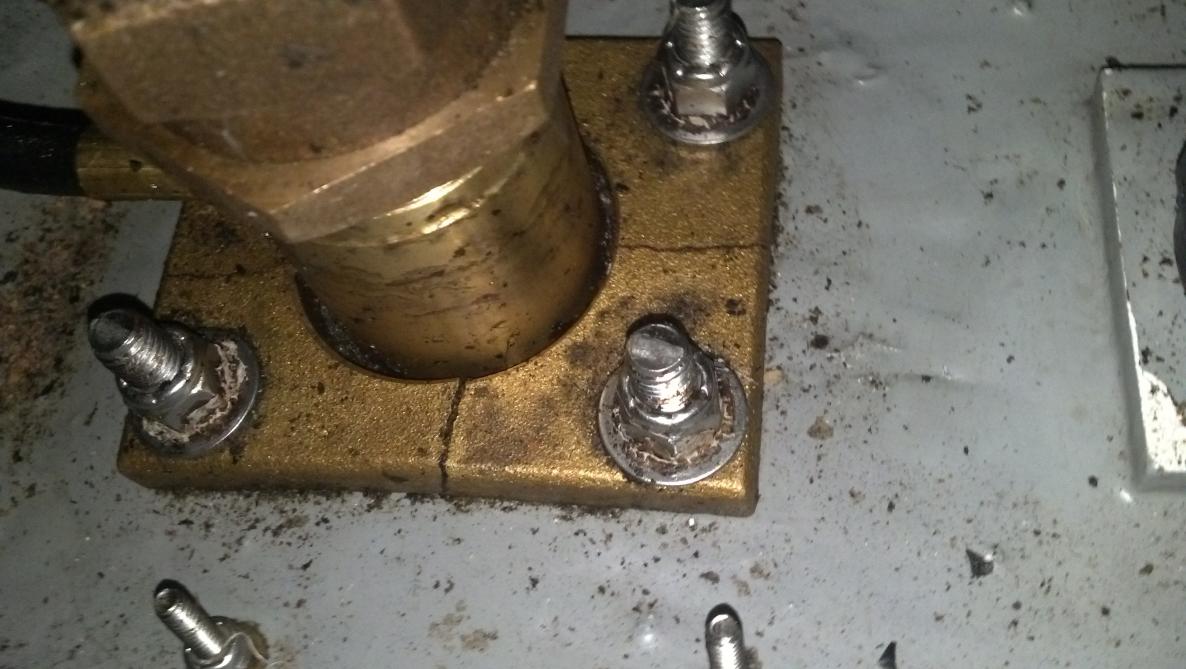

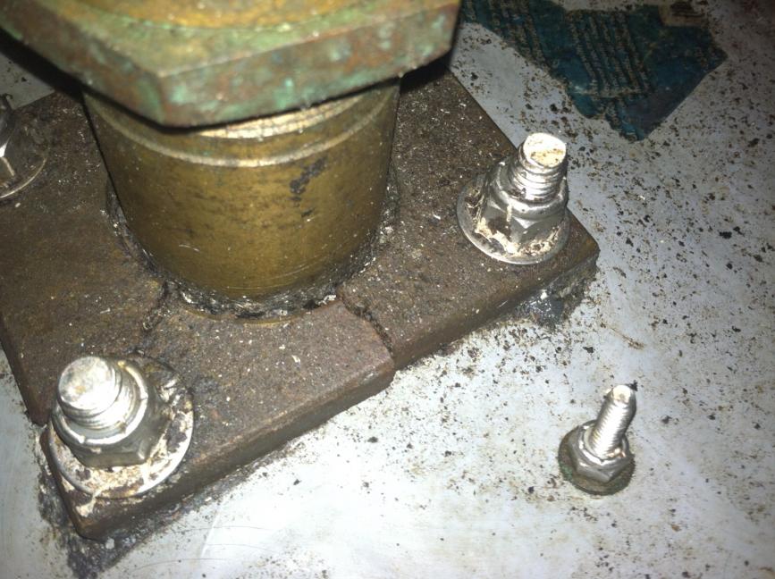

    I am having issues with my steering. It is very hard to steer to the right and the boat has been taking on water while underway. I filled the bilge with water and found a leak through one of the screws holding the rudder plate. I just noticed that the backing plate inside the boat is cracked. Has anyone seen or dealt with this problem. I did some research online and found mixed comments. Some said it is fine because the plate is acting like a washer. Others have said it absolutely shouldn't be cracked. Any insight would be great. Thanks for your help

    Yes, your rudder port backing plate is in poor condition. You should replace that as soon as you can.
      http://www.nautiqueparts.com/rudderport.aspx
      Discount code PND.
      It seems strange to me that such a soft material would crack like that.
      Anywhoo...time to replace.

          I have seen that before... what year is your boat? I suspect there may have been some bad castings.
          To suggest that the whole port needs to be replaced is ridiculous. That plate is in fact just a fancy washer. I'd see if you can buy just the backing plate separately. If not, I'd seriously consider using it as-is with some fresh sealant (3m 4200 or similar).

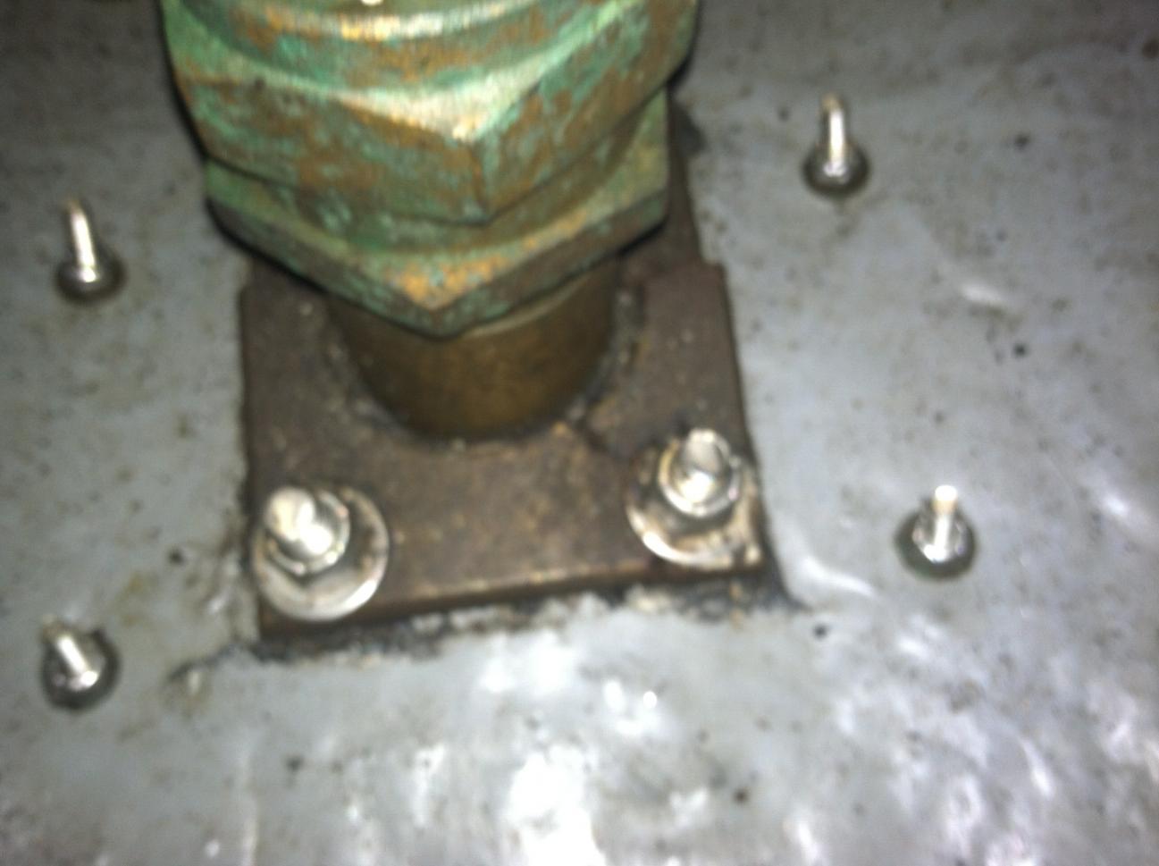

              Mine has the cracks too (2005 SAN210TE), but my steering works very well. I did not see copious amount of water coming in from the backing plate. Mine looks like it has not shifted as much as yours has. Perhaps the backing plate is dragging on the rudder shaft more in one direction of rotation than it is in the other, requiring more force when turning right, or you may want to check your steering cable. This is what mine looks like.

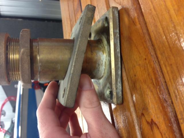

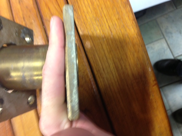

                          I almost bet the bed that the backing plate lies on is not 100% flat and if you install a new one it will crack as well. Like Tim said it's just a big washer and if it retains bolts it will be fine. There should be no way that would crack under heavy turn loads. that piece isn't the load bearing piece of the mechanism. The port itself bears the rudder load and that is distributed onto the rudder port pad where it mounts from the bottom. If something is flexing enough under turns to crack that backing plate then you have way bigger problems than that. Question your shops knowledge on that.........I included some pictures of a removed port. The backing plate is free floating and doesn't make a machined surface contact with the port bore. See pictures.Click image for larger version

                              I'm going to waffle and migrate to Tim's and Zach's position...now that I've studied it.
                              I'm wondering what it would cost to get a machine shop to machine that cover out of stainless steel or Cu-Ni plate. Then it wouldn't crack. Clearly its a crappy piece of cast material.
