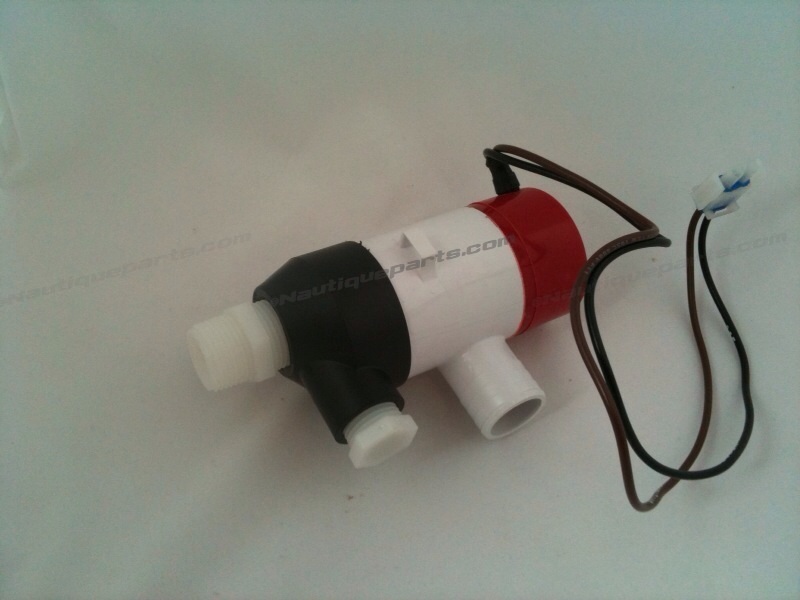

    Does anyone know where to get the connector for the ballast pumps on an 03 210? All I could find when searching was info about the gateway box connectors.

    I believe is is a connector made by AMP.
    You can also get a tool at auto parts stores that will push the electrical terminals out of the plastic body of the connector.
    Radio Shack also sell small Moldex connectors, that you could use.
    If possible, try to completely seal the wires to the bilge pump. if you have bare wires, in the bilge water, because the pump generally has power to it even when it is not running, one bare wires will quickly be eaten by electrolysis.

        I wish I could push the terminals out. The previous owner replaced the pump and just soldered the wires together. It makes it hard to do anything on that side since I can't disconnect the pump.
        I sent an email to AMP. I'll post here what the connector is for future info.

          I can't tell from your picture if these are the same as yours, but my 2004 air nautique uses 40006 for the pumps and 40011 for the main accessory harness under the dash.

            This is the response I got back from AMP:
            The portion of the assembly that TE/AMP makes would be the connector. 1-480698-0 with wire seal 794270-1. Our product details page provides a link to available contacts that will work on this plug:
            http://www.te.com/catalog/pn/en/1-48...QPN=1-480698-0
            It looks like they're the OEM, but I'm going to try and get some samples to see if they fit. I was planning on using these for the ASCO electric valves after I add them this winter also.
            The summit racing ones look to be the same, but the AMP ones seem to have an option for a water seal.
