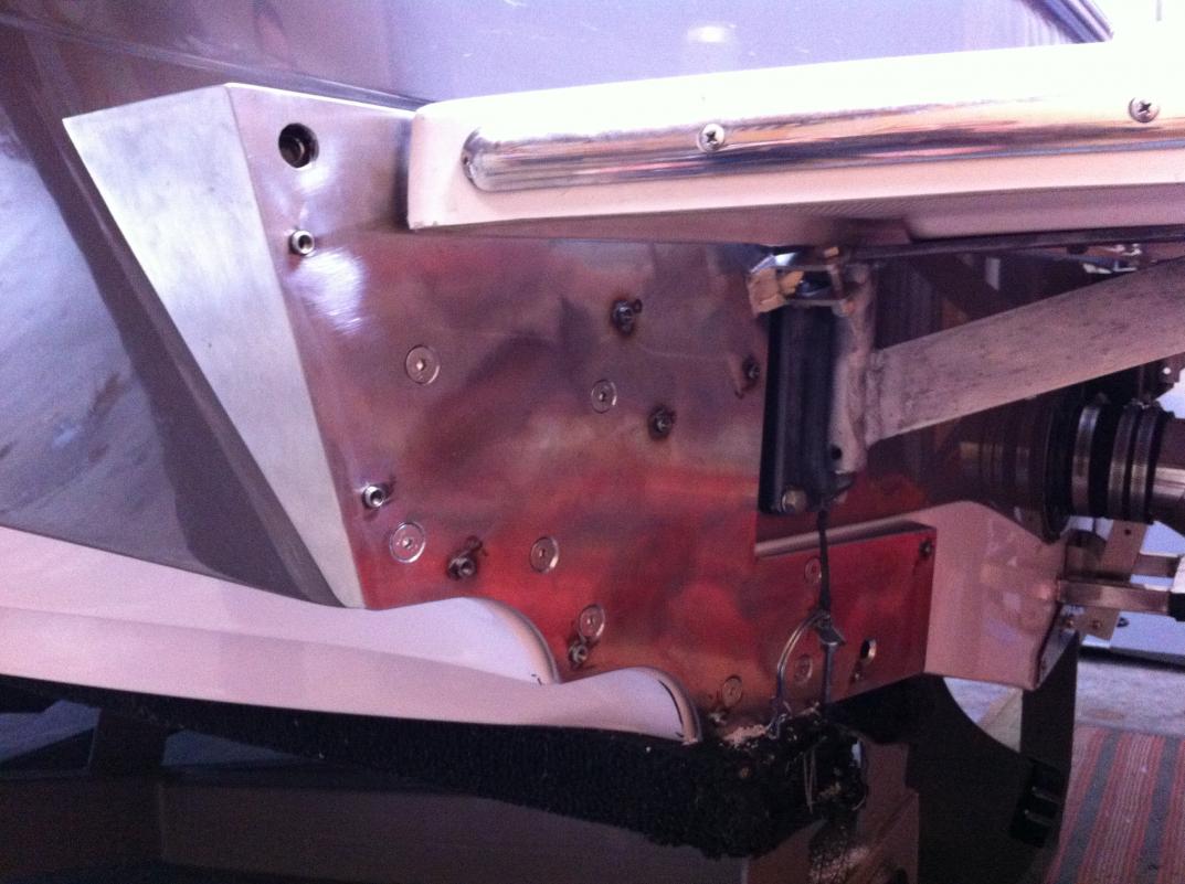

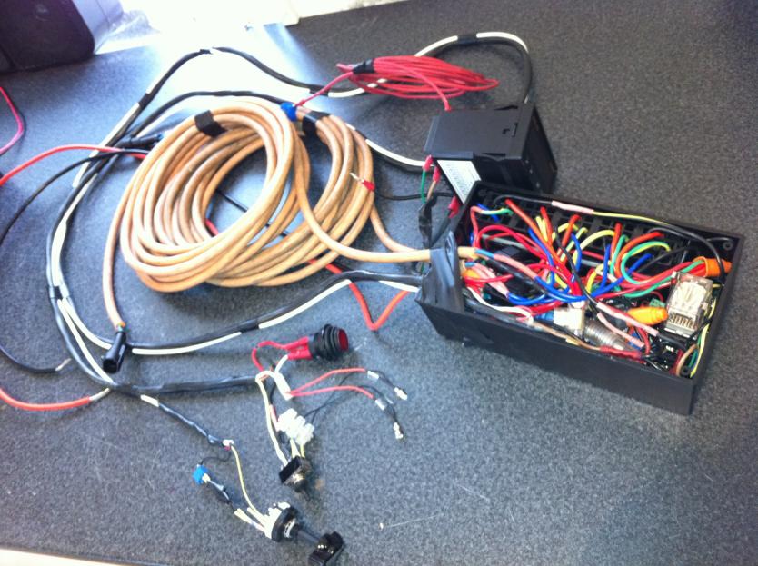

        okay so mine was kept under wraps until now, because i still havent water tested it, but bench tested electrics and sorted out faults. and it is winter here.
        built the plates off another design here and for our 220, and have manual fittings on them(3 different settings) until i get the electrics mounted
        will be using standard lenco actuators
        runs off paddle wheel.
        has mulitiple extension settings.
        auto extends the desired side at approx 5mph
        auto retracts the desired side at approx 15mph for safety
        can be switched side to side whilst underway, auto retracting the side you don't want.
        -all you do is turn on system
        -select desired extension on rotary switch
        -select desired side
        -and go surfing

            I have accidentally ran my tabs out at 25mph, did not test it above wakeboard speed. No damage. I also used thicker plate than they did.
            • 1955 classic
              • Apr 2013
              • 39
              • New Zealand
              #96
              have kept mine to 3mm stainless, plenty strong enough to do the job, but will bend if something is hit hard enough(hopefully never happens, but there is a thread or 2 with bent plates on G's), to save damaging the area where it bolts to the hull.
              Whilst it is not needed as it auto retracts, i have the output to run an audible alarm if needed
              may also powder coat outer panel to match hull colour, not sure yet

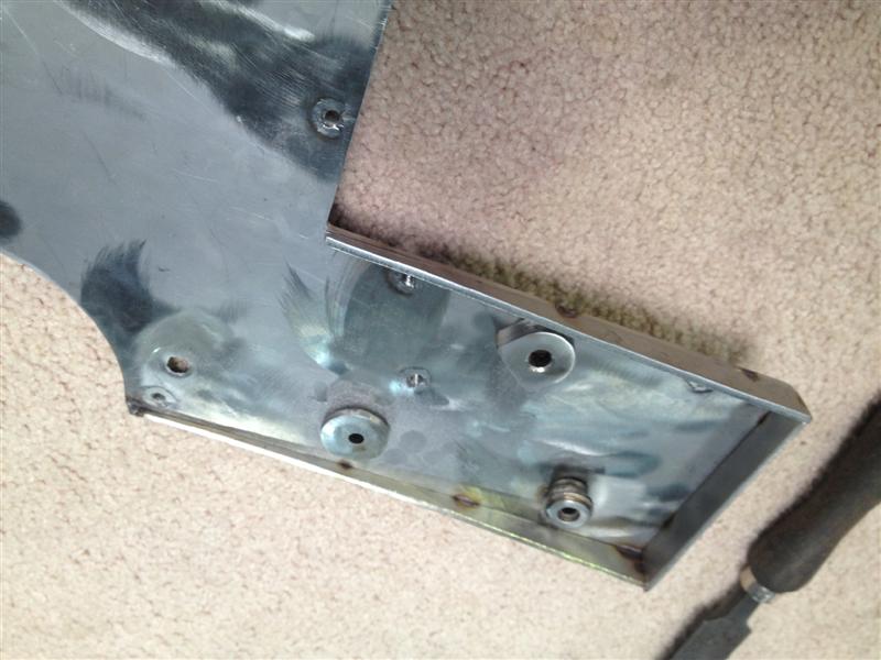

                #97
                @1955 classic: I dragged out the old laptop, and finally saw your pic this am! very nice work with the stainless! looks like you welded in the barrel nut, backwards? to get the spacing? looks nice?
                I would very much Love to see how you did your electronics? This is good stuff!

                    #99
                    Anchoring the filler bit?
                    [ATTACH=CONFIG]29144[/ATTACH]
                    Wow you guys have done some inspiring work! I have ordered a Lenco kit with 4.5" travel for my 2002 SAN to do something similar.
                    How do you anchor the "wedge" curve filler bit to the hull, can you show us a picture of the back side and how it screws/bolts onto the hull. Are there some hidden tabs and if so, how do you tighten them if they're hidden behind that filler enclosure?
                    THANKS FOR THE INSPIRATION!!!

                      #100
                      Mine just strait bolts thru the Back, it's not necessary to have a ton of bolts. The above picture is really over- built.

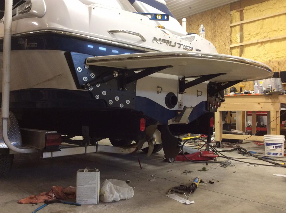

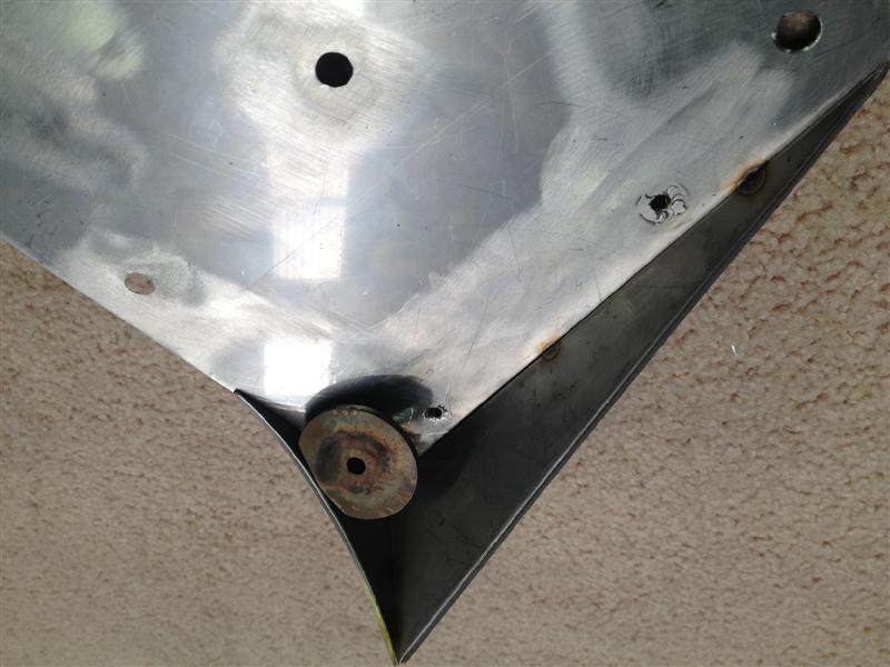

                      • AndrewC
                        • Jan 2011
                        • 105
                        • Austalia
                        • Nautique 220 Team
                        #101
                        I would not say it's over built. On boats like the 220, the radius on the back corner of the hull is quite large. This could potentially put the first fixing upto 5" in from the tip of the blade when extended. There is quite abut if leverage at that point.
                        Other boats like the new g series have non radius back corners which allow fixings to get close to the edge eliminating the need for as many bolts.
                        My system and the one above utilize a bolt that goes through the back corner radius on an odd angle. This reduced leverage and is critical as the when plate deployed, the whole plate mounting is really only as good as the the outer most bolts
Name:	IMG_1535 (Medium).jpg
                        Above photo is packers for section closest to middle of boar to compensate for curve in hull. Packers ensure pate it true and flat
Name:	IMG_1536 (Medium).jpg
                        Above photo shows corner bolt and packing behind to stop from pulling plate out of flat when bolted up hard to hull
