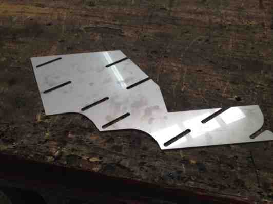

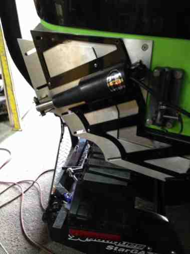

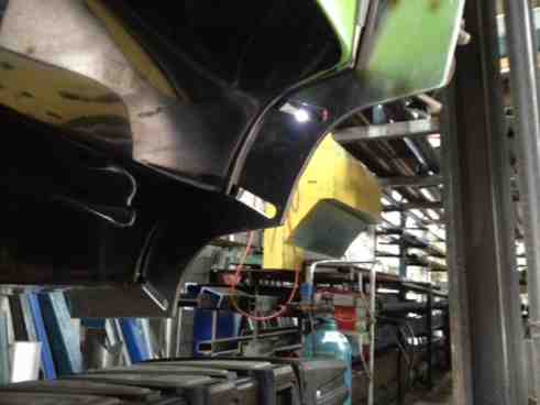

      I have ordered the new lenco actuators and waiting for them to ship from the US to AUS. I have had the new plates cut which will allow another 19mm extension to match the factory plates. These are now also 3mm thick rather them the previous ones being 2mm. Hopefully I will have it all together by next weekend pending the timely arrival of the actuators from FedEx.
      Yesterday I also installed the gps over speed alarm as well which seems to work well. It sets an alarm off when the boat exceeds 15mph when the NSP system is on and will also sound an alarm if the gps signal is lost.
      Here's some photos from the last weekend as well as the new plates
