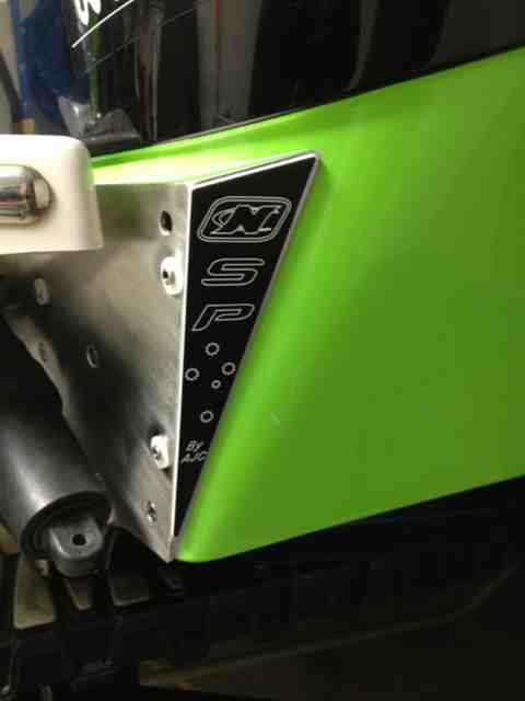

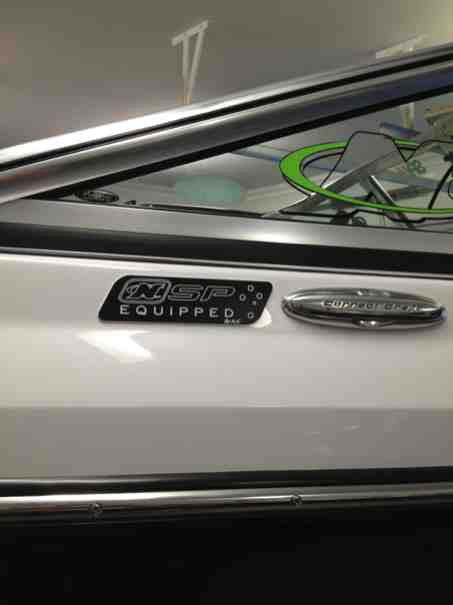

    Still waiting in painted bits and the last ram so my over the top side came out and I made some badges at work for the setup

      Awesome, love the finishing touches! I like your overall solution a little better than the CC version for the 230 I saw...CC used a piece of plastic to take up the gap/curvature of the transom. I also really like the CNC/engraving work on the plates, very nice...

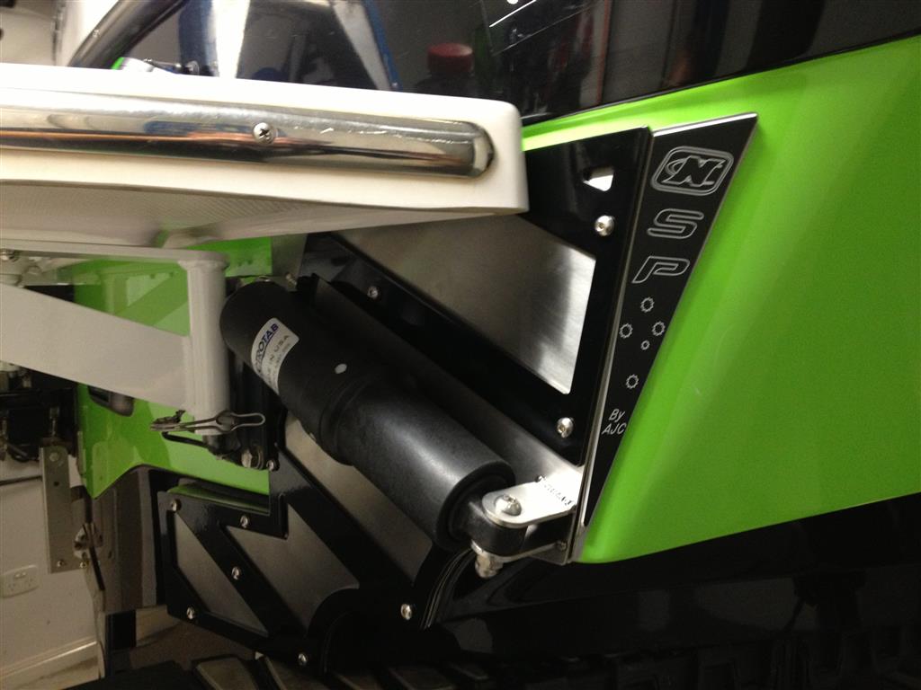

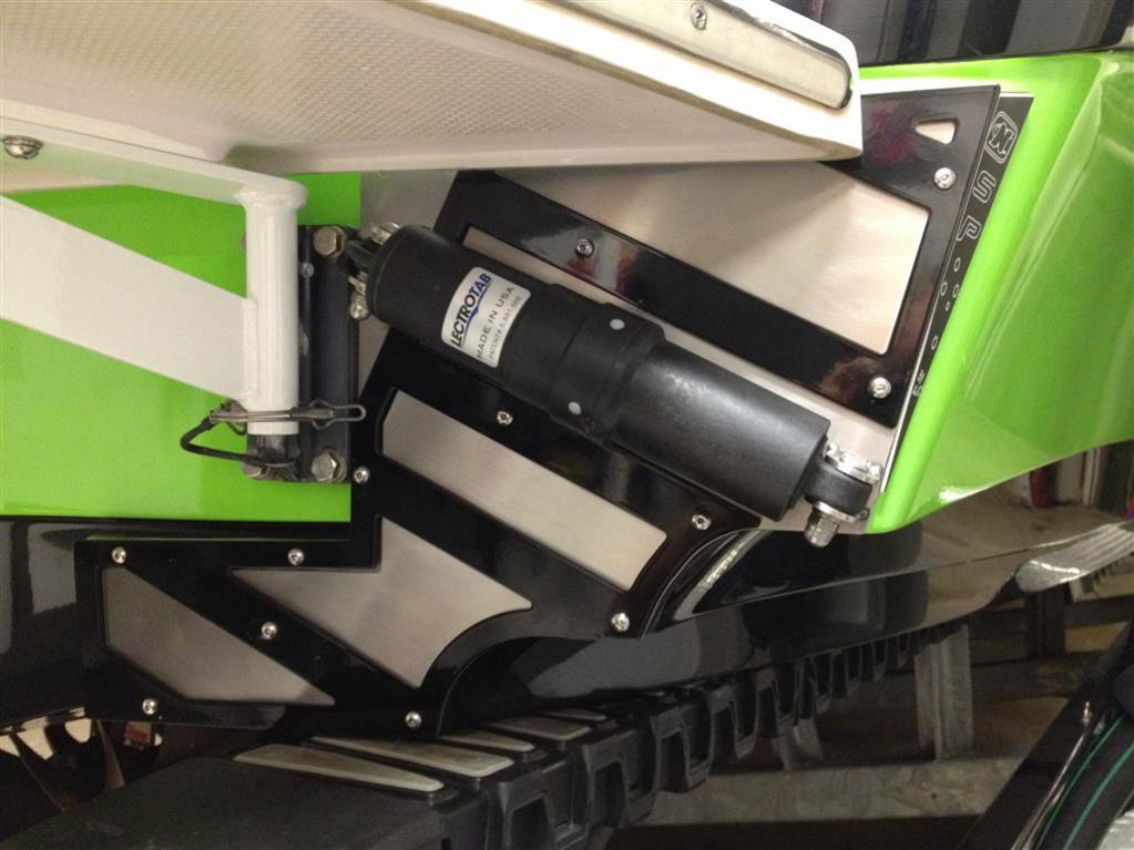

                Well all finished, just need to get to the water in 2 weekends time. Will try and get some video.

                  This is amazing. Great work and attention to detail. Cant wait to see videos.

                    I can't wait either. I do have some concerns though that the actuator travel is not long enough. The lenco ones are longer in the body and the travel and I thought I would not get them to fit. Turns out that they probably would have, just. They extend three quarters of an inch further. Hope fully this is not the difference between success and failure.
                    All would not be lost, different slider plates could be installed with ease but the additional $700 in actuators would hurt!
                    Only time will tell

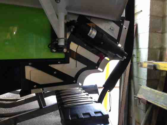

                      Do you have any pictures of the finished plates extracted?

                          #57
                          The plates won't deploy whist on the trailer due to them hitting the bunks. I am lifting the boat tomorrow to check the travel and will snap some photos then.

                                #60
                                Deployed photos
