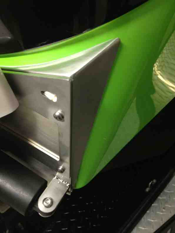

                  Platform got remounted 10mm back tonight and Plates are bolted on. Boat is heading to work tomorrow for some final bits to be welded to the backing plate to suit the curves of the boat.

                  • Miljack
                    • Dec 2004
                    • 1635
                    • Charlotte, NC
                    • '08 230 TE ZR6
                    #39
                    Great work Andrew! Did you use a piece of nylon or plastic against the hull? Please post up your components when you have a chance...

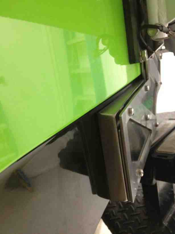

                      We are just in the process of that now. Using stainless steel as we speak. In filling on the top left corner and bottom right

                        I see, so the 220 hull has a lot of curvature right at the transom, wow, that's a great looking fabrication job! Looks like you welded in some "top hat" style threaded bushings to attach your outer plate, and those are doubling as the location/slider points for the plate that moves?

                          Spot on. The pips double as slide runners externally and the internal threat gods the outer plate on. Since this photo, the also included mountings to the hull on the outside corner radius. Will be doing final mounting tomorrow and will post more pictures. Still am planning on getting a couple bits powder coated next week.

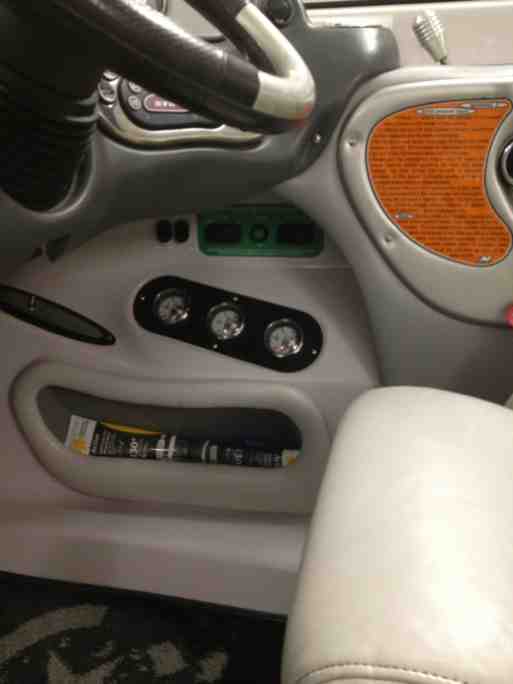

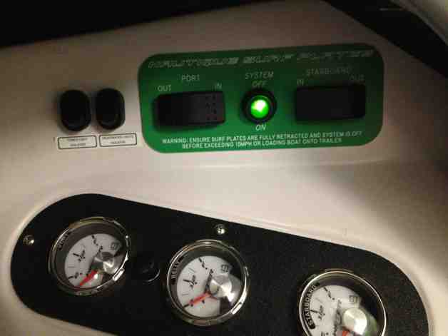

                          Also just mounted the control panel

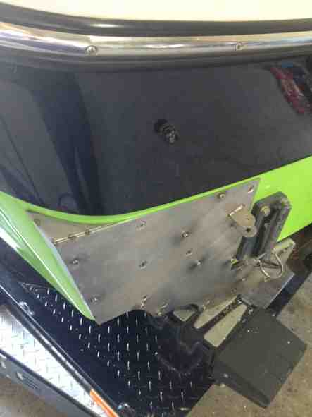

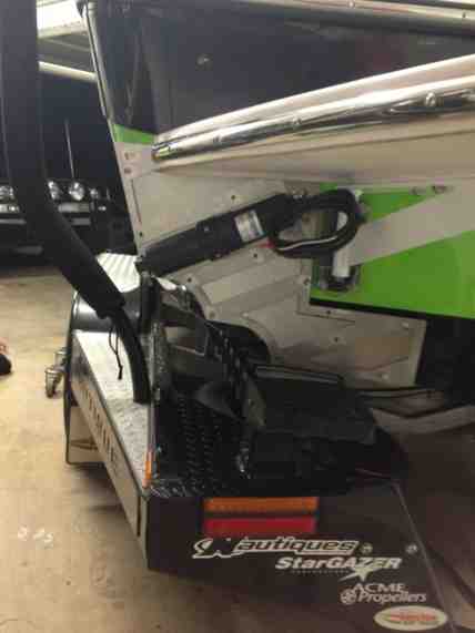

                            99% finished. Just going to powder coat the retaining panel black Monday to get a nice stainless / black contrast happening.
                            Everything is wired up and ready to go. Just need to lift the boat on the trailer at work to check the movement as the tabs cannot be deployed on the trailer due to the long bunks.
