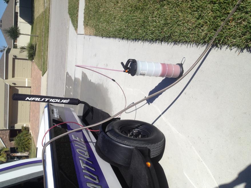

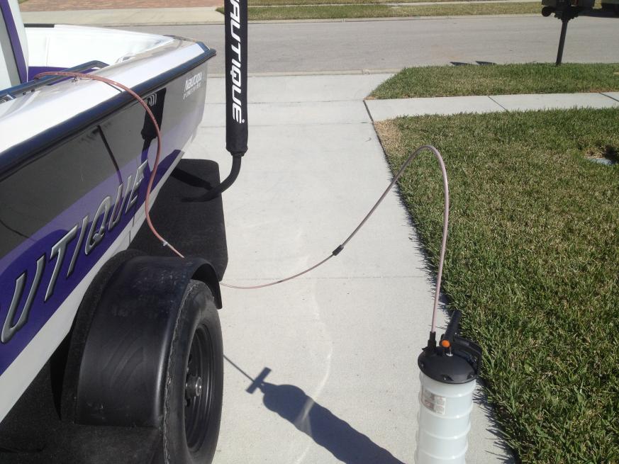

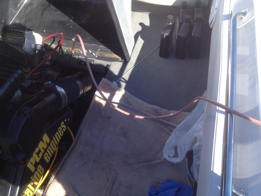

If you have the 1.23 to 1 transmission, the top oil line goes to the oil cooler, and the cooler returns fluid to the sump of the transmission.
If you disconnect the top line, WITH THE ENGINE NOT RUNNING, you can blow air into the hose, and push the fluid in the cooler back into the transmission, and then suck it out. This leaves less fluid in the transmission, and if you are changing fluid types, or trying to get rid of water contaminated fluid, you need fewer oil changes to completely flush the transmission.
Listen to air tool on this one. DO NOT stick a plastic hose in your transmission! There is a very high chance it will get stuck and that is not good! I've heard of guys having to pull their transmissions out and taking it apart to get the pieces out. I did air tools setup as shown above and got a fluid extractor. Mine is from west marine, nautiqueparts.com has one like it also.

1 -Start by warming up the transmission, I ran my boat for about an hour, and then the book will tell you to check level by putting it in neutral, then shifting into gear back to neutral and back into gear.
1.5- I lifeted up my floor access hatch
2- Extract all the fluid I used my oil extractor (http://www.siriusconinc.com/ebayimages/PL-6000.jpg) takes about 5-10 mins when warm.
3 - The ATF fluid had a liquid style hand pump with plastic hose, so I put a funnel in dipstick tube and added about 2 quarts, checked levels every 30 minutes for the next 2 hours.
