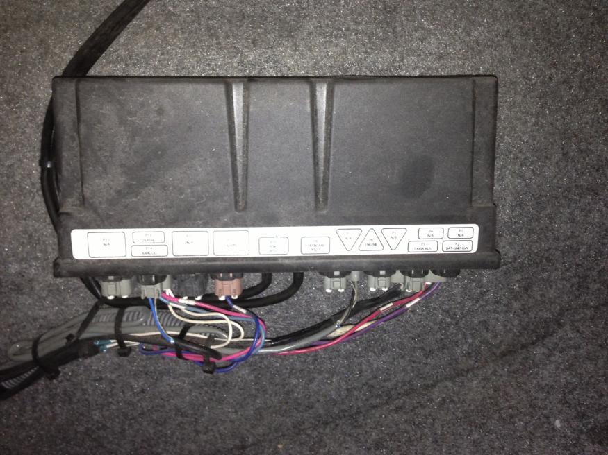

Originally posted by Texas88 View PostAny idea how to test a Gateway? Several of my gauges don't work, checked connections etc but signs point to the Gateway. Hate to shell out $850 for a new one.
Does anyone know of a Used one by chance? The box says Faria model # GW0005B
[ATTACH=CONFIG]25147[/ATTACH]
Disclaimer!! the following comes from an automotive background, not marine, so don't take the following info to the bank..lol
If only some of your gauges are inoperative and not all, I would lean toward an instrument cluster problem or a missing input to the gateway from a sensor. Something like temp gauge not working because temperature sending unit not working. The serial bus is operational if some of the gauges on the serial bus still work. It should be an all or none type thing. Sometimes removing both battery cables and jumping them together for a few minutes will reboot a "stunned" or "locked up" control unit.
Serial bus control units generally need 3 things to operate. They need a power supply (12 volts), a ground source, and operational communication lines (positive and negative). Most controllers have more than one power supply and sometimes more than one ground. You will need a wiring diagram to troubleshoot. Also, a pin out of the gateway connector would be helpful, but not necessary. Usually the communication lines are toggled from 0 to 5 volts when working properly. An oscilloscope is the best way to check for the signals, but you can use a voltmeter. The voltmeter will not show the oscillations in voltage because it is to slow, but should show an average of around 2.5 volts.
This may not apply, but I am assuming the system works like an automotive can bus, when the modules are powered down there should be 60 ohms between the + and - communication lines. A reading of 120 ohms means there is an open circuit in one of the communication lines or a module has failed. Again these readings are with everything powered down.
I'll will be glad to clarify and answer any more questions, but I don't want to go on and on. Good luck getting it fixed!
